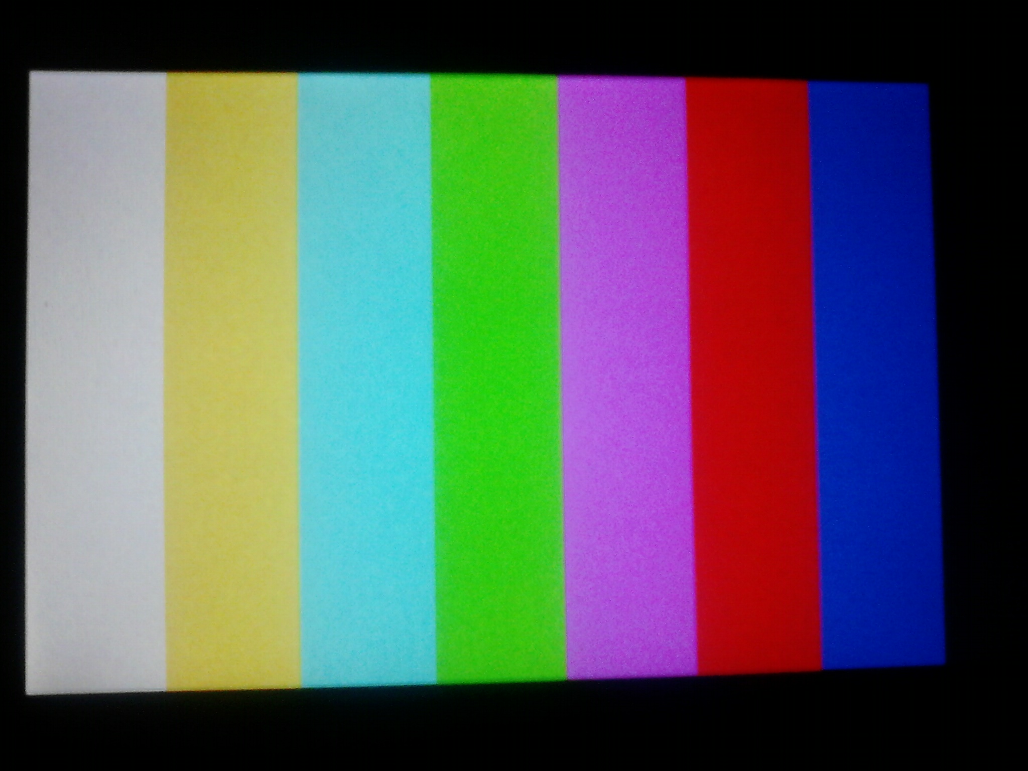

  • Hi Rajesh,
    After the last step, can set bit15 at the offset 0x4810a000 and see if you are getting correct color bar on LCD?
    Rgds,
    Brijesh
  • Hi Brijesh,
    Thanks a lot for your support.
    yes I am getting color bar on LCD after setting bit15 at the offset 0x4810a000.
    But when I am trying to display mipi camera  captured contents on LCD, noting is comming. However I am able to display the mipi camera captured contents on HDMI.
    Kindly suggest me,
    regards:
    Rajesh Singh
  • Hi Rajesh,
    Since the color bar output is correct, VENC settings and LCD is settings are correct, now you need to make sure that input pipe line settings are correct. Is your captured frame size same as LCD frame size? I am asking this question because it works fine on HDMI.
    What do you see on LCD when you try to display image?
    Rgds,
    Brijesh

  • Hi Brijesh
    Following are the output which I observed for your suggested steps:
    1.  I  am able to display LCD patterns, after the screen is getting black.
    2. I  have changed following the following files in IPNC RDK 3.5  for TI_8107_BUILD.
         Red color shows what I have added.
         In File :  mcfw/demos/mcfw_api_demos/multich_usecase/ti_mcfw_ipnc_main.c
    Void App_loadDemo(Void)

  • Hi Brijesh,
    Thanks for your valuable suggestions. Now LCD display is working. but one issue. Display seems to have some noise or someting.
    I am sharing one image, please have a look and suggest me some possible causes for this.
    Regards:
    Rajesh Singh
  • Hi Rajesh,
    Again check the internal color bar, if it is correct, venc is providing correct data. These artifacts are coming from somewhere in your pipeline.
    Brijesh
  • Hi Brijesh,
    Thanks for reply.
    I tested the internal color bar, and it is OK. I am still trying to figure out the cause.
    Regards:
    Rajesh Singh
  • Hi Brijesh,

    system("echo 0 > /sys/devices/platform/vpss/display1/enabled") ;
    system("echo 33500,800/164/89/10,480/10/23/10,1 > /sys/devices/platform/vpss/display1/timings") ;
    system("echo triplediscrete,rgb888 > /sys/devices/platform/vpss/display1/output") ;
    system("echo 1 > /sys/devices/platform/vpss/display1/enabled") ;
    Replace green line with yours LCD configration.
