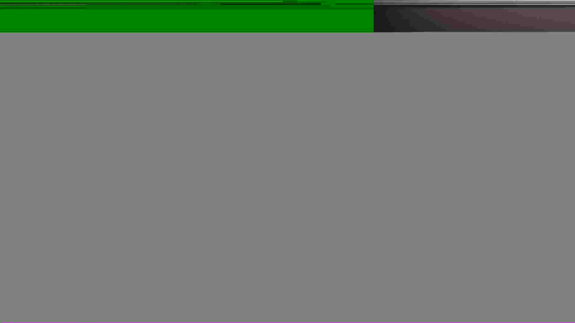

why i get the frame from VIN0 PORTA is broken?
6175.multich_uw_fullfeature_cap.c

#define GET_FRAME_FROM_VIP0PORTA  (1)
 * Use case code
#if GET_FRAME_FROM_VIP0PORTA
static SystemVideo_Ivahd2ChMap_Tbl systemVid_encDecIvaChMapTbl = {
    .isPopulated = 1,
    .ivaMap[0] = {
				  .EncNumCh  = 2,
				  .EncChList = {0, 1},
                  .DecNumCh = 0,
                  .DecChList = {0, 0},
    .ivaMap[1] = {
                  .EncNumCh = 2,
                  .EncChList = {2, 3 },
                  .DecNumCh = 0,

	/* Camera Link params */
	CaptureLink_CreateParams_Init(&capPrm);
	capPrm.outQueParams[0].nextLink  = mergeId[CAM_STREAM_MERGE_IDX];
	capPrm.outQueParams[1].nextLink  = mergeId[CAM_STREAM_MERGE_IDX];
	/* This is for TVP5158 Audio Channels - Change it to 16 if there are 16
	 * audio channels connected in cascade */
	capPrm.numVipInst = 1;
    capPrm.tilerEnable = FALSE;
    capPrm.numBufsPerCh = 6;
    capPrm.numExtraBufs = 6;
    capPrm.numAudioChannels= 0;
    capPrm.fakeHdMode = FALSE;
	capPrm.isPalMode=FALSE;
	capPrm.enableSdCrop=FALSE;
	capPrm.doCropInCapture=FALSE;
	pCapInstPrm                     = &capPrm.vipInst[0];
	pCapInstPrm->vipInstId          = SYSTEM_CAPTURE_INST_VIP0_PORTA;
//	pCapInstPrm->videoDecoderId     = 0;//SYSTEM_DEVICE_VID_DEC_SII9135_DRV;// SYSTEM_DEVICE_VID_DEC_TVP7002_DRV;// SYSTEM_DEVICE_VID_DEC_TVP5158_DRV;
	//MultiCh_getSensorId(gUI_mcfw_config.sensorId);
	pCapInstPrm->inDataFormat       = SYSTEM_DF_YUV422P;//SYSTEM_DF_YUV422I_UYVY;// SYSTEM_DF_YUV422P;//  SYSTEM_DF_YUV420SP_UV;
	pCapInstPrm->standard           = SYSTEM_STD_1080P_30;
	pCapInstPrm->numOutput          = 2;
	/* First stream */
	pCapOutPrm                      = &pCapInstPrm->outParams[0];
	pCapOutPrm->dataFormat          = SYSTEM_DF_YUV420SP_UV;
	pCapOutPrm->scEnable            = FALSE;
	pCapOutPrm->scOutWidth          = 0;//uw_ch_width;
	pCapOutPrm->scOutHeight         = 0;//uw_ch_height;
	pCapOutPrm->outQueId          = 0;
	/* second stream */
	pCapOutPrm                      = &pCapInstPrm->outParams[1];
	pCapOutPrm->outQueId          = 1;
	mergePrm[CAM_STREAM_MERGE_IDX].inQueParams[0].prevLinkId = gVcapModuleContext.captureId;
	mergePrm[CAM_STREAM_MERGE_IDX].inQueParams[0].prevLinkQueId = 0;
	mergePrm[CAM_STREAM_MERGE_IDX].numInQue = 2;
    mergePrm[CAM_STREAM_MERGE_IDX].inQueParams[1].prevLinkId = gVcapModuleContext.captureId;
    mergePrm[CAM_STREAM_MERGE_IDX].inQueParams[1].prevLinkQueId = 1;
    mergePrm[CAM_STREAM_MERGE_IDX].outQueParams.nextLink = gVcamModuleContext.ipcFramesOutVpssToHostId;
    mergePrm[CAM_STREAM_MERGE_IDX].notifyNextLink = TRUE;

i use ipnc rdk3.5.0, 8147, get frame from vin0 porta,
pVipCreateArgs->videoCaptureMode = VPS_CAPT_VIDEO_CAPTURE_MODE_SINGLE_CH_NON_MUX_DISCRETE_SYNC_HSYNC_VSYNC;
pVipCreateArgs->videoIfMode = VPS_CAPT_VIDEO_IF_MODE_16BIT;
i got the frame , but the frame is broken ? my image like this.
i set 1080P_30, but fps is 233 , very odd !!!
mylog:
 [m3vpss ]  *** CAPTURE Statistics ***
 [m3vpss ] 1017068: CAPTURE: Queued to driver = 232041, Dequeued from driver = 232027
 [m3vpss ] CAPTURE [0] Buf Q Status
 [m3vpss ] Empty Q -> count 0, wrPtr 0, rdPtr 0
 [m3vpss ] Full Q -> count 0, wrPtr 378, rdPtr 378
 [m3vpss ]  1029612: CAPTURE: Fields = 7009 (fps = 233), Total Resets = 0 (Avg 0 ms per reset)
Look forward your reply. Thanks,
