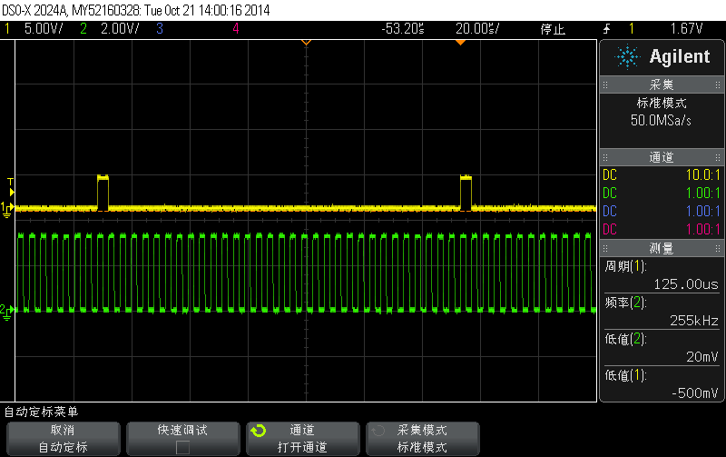

Yellow pulse wave ---> pcm_sync 8k;  Green pulse wave -->pcm_clk 256k

      thank you for your support,I have fix it now ,My bluetooth can work. can aplay and record voice.
     ap6234-bt receiver samples data on the falling edge of the serial clock,but mcasp4 was configed falling edge, it is wrong.
    Accroding to mcasp configurations in sprugz8e.pdf (dm8148 datasheet)  , Chapter 16,
    CLKXP                  Transmit bitstream clock polarity select bit.
                               0  Rising edge. External receiver samples data on the falling edge of the serial clock, so the transmitter must shift data out on the rising edge of the serial clock.
                               1  Falling edge. External receiver samples data on the rising edge of the serial clock, so the transmitter must shift data out on the falling edge of the serial clock.
    so i change  the register CLKXP value
