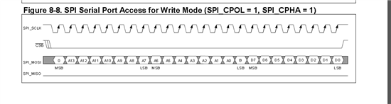

    I try to read/write DS26521 chip now.But I don't know how to do.
    f
    w
    Would you give me some suggestions ? Thank you very much.
    BR
    Bob
  • Hi Pavel,
    For example,if I want to read DS26521 chip ID,but how to send the command to the chip ?
    I find the Device Identification register (IDR) is 0x0F8 and "1" stands for read.
    So I could send 0x10F8 to the register.Is it right?
    BR
    Bob
