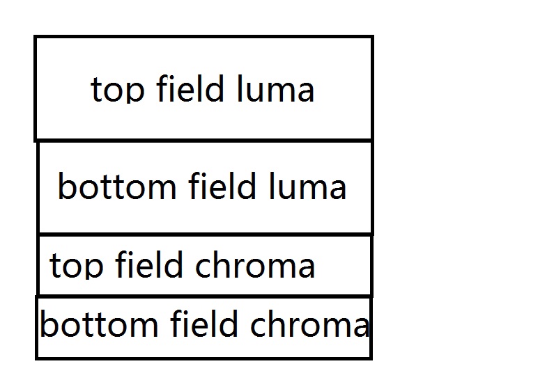

    On http://processors.wiki.ti.com/index.php/VENC chapter 4, there is a sentence as this:
    " Please note encoder would expect field separated mode, in same buffer"
    what's the meaning of it?
    the input video must have  data format like this:
    1) topfield luma block,  bottomfield luma block,  topfield chroma block,  bottomfield chroma block
    or like the another one ?
    2) topfield luma block, topfield chroma block,  bottomfield luma block,  bottomfield chroma block.

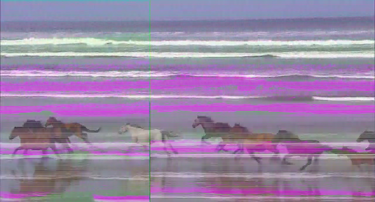

    After h264 progressive encoding, around moving object, there are always edge distortion.
    Then I tried the interlaced encoding, but I have not achieved to do it so far.
    I have convert the capture output to field seperated, but the problem still exists.

  • Below is interlaced encode result(input 4:2:0 semi-planar, two field seperated)

  • Hi
    I have tried with the setting you provided, but result keeps same.
    There are apparent chroma error in the video after the bitstream file is decoded, just as the image I posted previously.
    In My input 420 semi-planar YUV video, two fields are separated. Is there any difference in input buf format?
