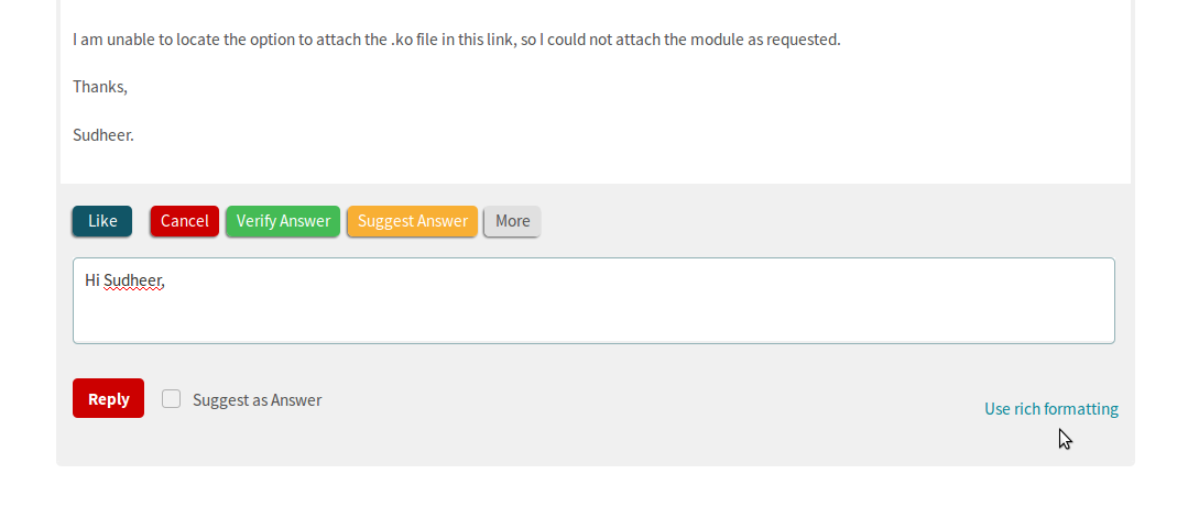

    I am unable to locate the option to attach the .ko file in this link, so I could not attach the module as requested.
    You should click on the "Use rich formatting" button in the right down corner (see screen shot) then you should drag and drop the file you want to attach.
