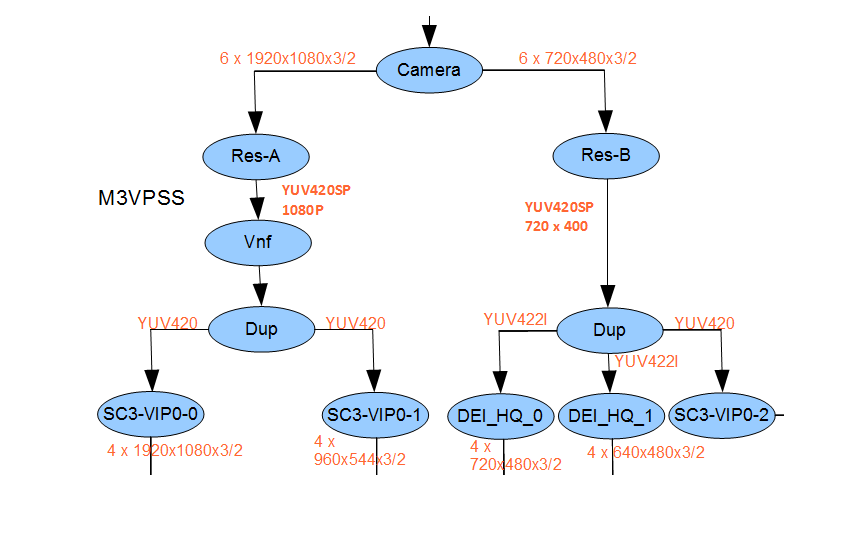

My Usecase for 4 channel H.264 is as follows:

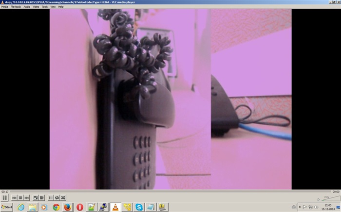

When I apply Tiler, first 2 streams (1920x1080 & 960x544), which passes from Scaler 0 and scaler 1 - are rotating fine, it rotates on 90 degree and 270 degree.
But, Other 2 streams (720x480 & 640x480) not rotating properly, which passes from DEI0 and DEI1, as you shown in below picture.

    Your use case diagram shown YUV422I input to the DEI links.
    Is this correct? Can you check this?
    regards,
    Anand
  • Hi Anand,
    Actually Mistake in diagram only. Not in code.
    DUP gives YUV420, which sends to DEI0 and DEI1.
    The current implementation of the DEI link doesn't support handling of the input Real Time (RT) params.
    Any dynamic change in the input resolution is not supported.
    When you rotate 1920x1080 input by 90 degrees the resolution is dynamically changed to 1080x1920 but the DEI link will still treat the input as 1920x1080.
    We need to add support for handling the input RT params in the DEI link and provide you the patch.
    I can provide the patch by end of next week.
    However, the scaler link suports input RT params you still need to change the output resolutions manually by calling the 'Vcam_setScalarOutResolution()' API otherwise it continues to scale to the original output resolution.
    For eg if scaler input is 1920x1080 and output is 720x480.
    After rotation the input becomes 1080x1920 but output is still 720x480 now it does scaling from 1080x1920 to 720x480.
    So you need to call the Vcam_setScalarOutResolution() API to change the output resolution to 480x720.

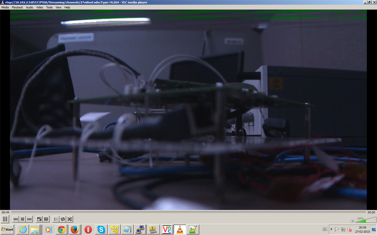

    Screen Shot:
    You Can see "Green" lines at top of the screen.
    Sandip Gokani.

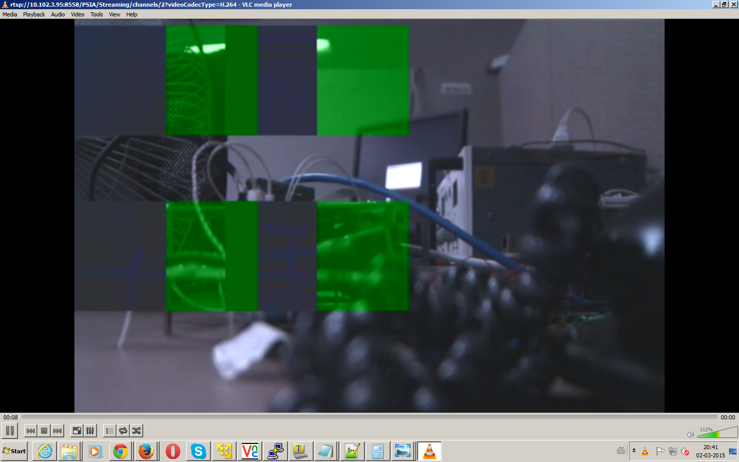

  • Hi Anand,
    Thanks for your feedback.
    It works with negative value of pitch, but I got some offset because of "maskAddr" calculation. I tried out to change calculation as you can see below (but it was just tring to find out solution, but still not succeed....There is some OffSet)
    Code for your reference :
    FrameAddrUV     = (Ptr) ((UInt32)pFrame->addr[0][1] + ( startX + ((startY/2) * pitch[1])));
    FrameAddrUV     = (Ptr)Utils_tilerAddr2CpuAddr((UInt32)FrameAddrUV);
    maskAddr        = (UInt32) FrameAddrUV;
    maskAddr += (((height/2 - 1) * pitch[1]) + (width/16));

    Snapshort :
    Please, If possible then help me on calculation of Maskaddress.
    Sandip Gokani
    Why are dividing width by 16 while calculating the end UV plane address?
    regards,
    Anand
  • Hi Anand,
    Its just to get for solution & for that I am trying to modified calculation on trial base. I know its not a perfect calculation.
    But, As per your suggestion on earlier reply, with following calculation --> There is a big offset.
    maskAddr += (((height/2 - 1) * pitch) + width);
    Snapshot for above calculation :
    So, I just tried to reduce a offset with dividing width by 16. I also tried with dividing width by 32, but same a small offset is remaining there.
    It is possible to provide me a perfect calculation for MaskAddr for UV plan?

  • Hi Anand,
    My earlier calculation is :
    maskAddr += (((height/2 - 1) * pitch[1]) + (width/16));     [Please change the calculation]
    /* UV-plan */
    DM81XX_EDMA3_memset( DRAW_EDMA_CHID_DRAW,
                    DRAW_EDMA_QUEUEID_DRAW,
                    gColorInfo[colorId][1],
                    maskAddr,
                     width,
                     height/2,
                   -pitch[1] );
    Sandip Gokani
    OK, got it.The EDMA copy doesn't happen in reverse direction in Horizontal direction.
    So the correct address calculation is:
    maskAddr += ((height/2 - 1) * pitch[1]);
    regards,
    Anand
  • Anand,
    Thanks a lot, Issue is resolved.
    Sandip Gokani
