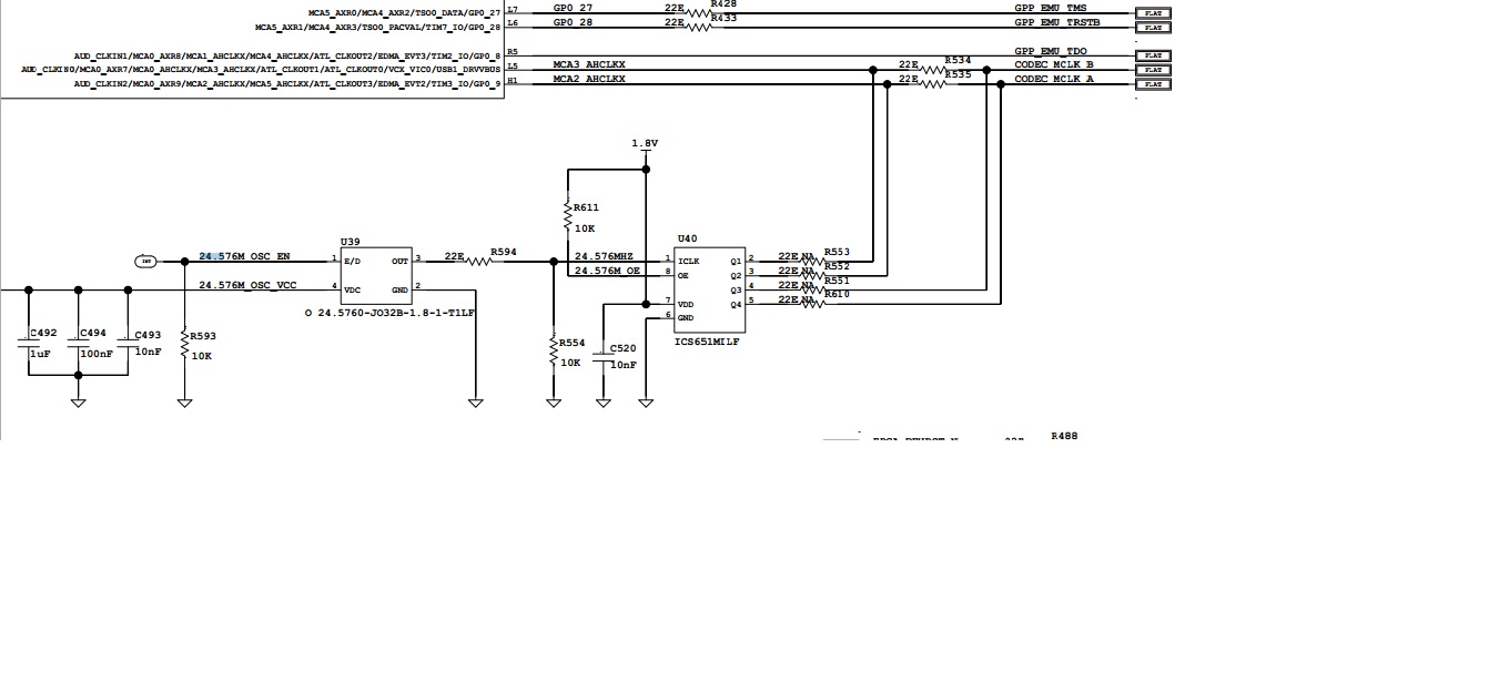

  • Hi Pavel,
    This is the schema for the audio pll for mcasp 2&3, with the oscillator of 24.576Mhz.
    I am not a HW engineer (I will later check it with the HW staff) , but as far as I understand from this schematic, it seems that we use  MCASP2_ACLKHX/MCASP3_ACLKHX.
    Does it explain the wrong speed ?
    Thank you very much for your time.
    Ran
    I do not see how Audio PLL is involved here. Can you clarify on that point?
    So finally, what is the source for the codec MCLK: MCA2_AHCLKX or oscillator U39?
    BR
    Pavel
  • Ran,
    If NA means that these resistors (R553, R552, R551 and R610) are not mounted, then the clock source for the codec MCLK will come from AHCLKX, not from U39 oscillator. Thus you will need to set up the right frequency for this pin. You can refer to the J5Eco/DM811x/TI811x linux kernel code base, where the same approach is applied.

  • Hi Pavel,
    The initial HW design aim was to give two alternatives ,so that in case we have problem in one of them, we can try the other....
    But Now I start to suspect that maybe these 2 alternatives interfere with each other ? Our SW is based on dm8148 evm
    Ran
  • Ran,
    You can not have these two alternatives at the same time. If you have these resistors (R553, R552, R551 and R610) populated on the HW, then the U39/U40 alternative can not be controlled, it will be aways active (U40 OE is aways high), thus when you set the other alternative (AHCLKX), there will be conflict between these two.
    So make sure:
    1. If you need U39/U40 alternative, remove resistors R552, R553, R534, R535. And populate resistors R551 and R610
    2. If you need AHCLKX alternative, remove resistors R553, R552, R551, R610. And populate resistors R534 and R535
    BR
    Pavel

  • Hi Pavel,
    The NA means that it is not connected (not assembled). It mans that we are using AHCLKX alternative . So as I understand there is some reference in DM811X for using it ?
    Do you have a more specific pointer as to where it is configured in code ?
    Another question - Is there any reason why EVM uses external oscillator and not AHCLKX ? I ask becuase if there is some issue here (performace, etc.) which makes the external oscillatorm a better choice, we might want to change HW for that alternative.
    Ran
