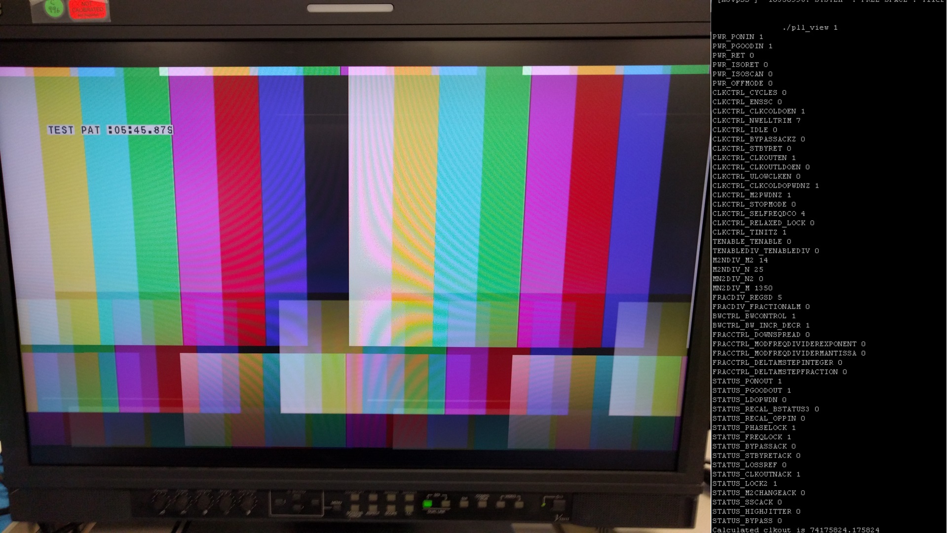

  • I think our clock settings as is are OK.  1350,25,14 as M,N,M2 work well for matching the SMPTE standard of 74.25/1.001 MHz  - but I must be missing something else.
    This is how the video looks when the clock is set to 74.25/1.001 MHz.  This is with our own timings, not any from TI.  The PLL settings are superimposed to the right of the screen:

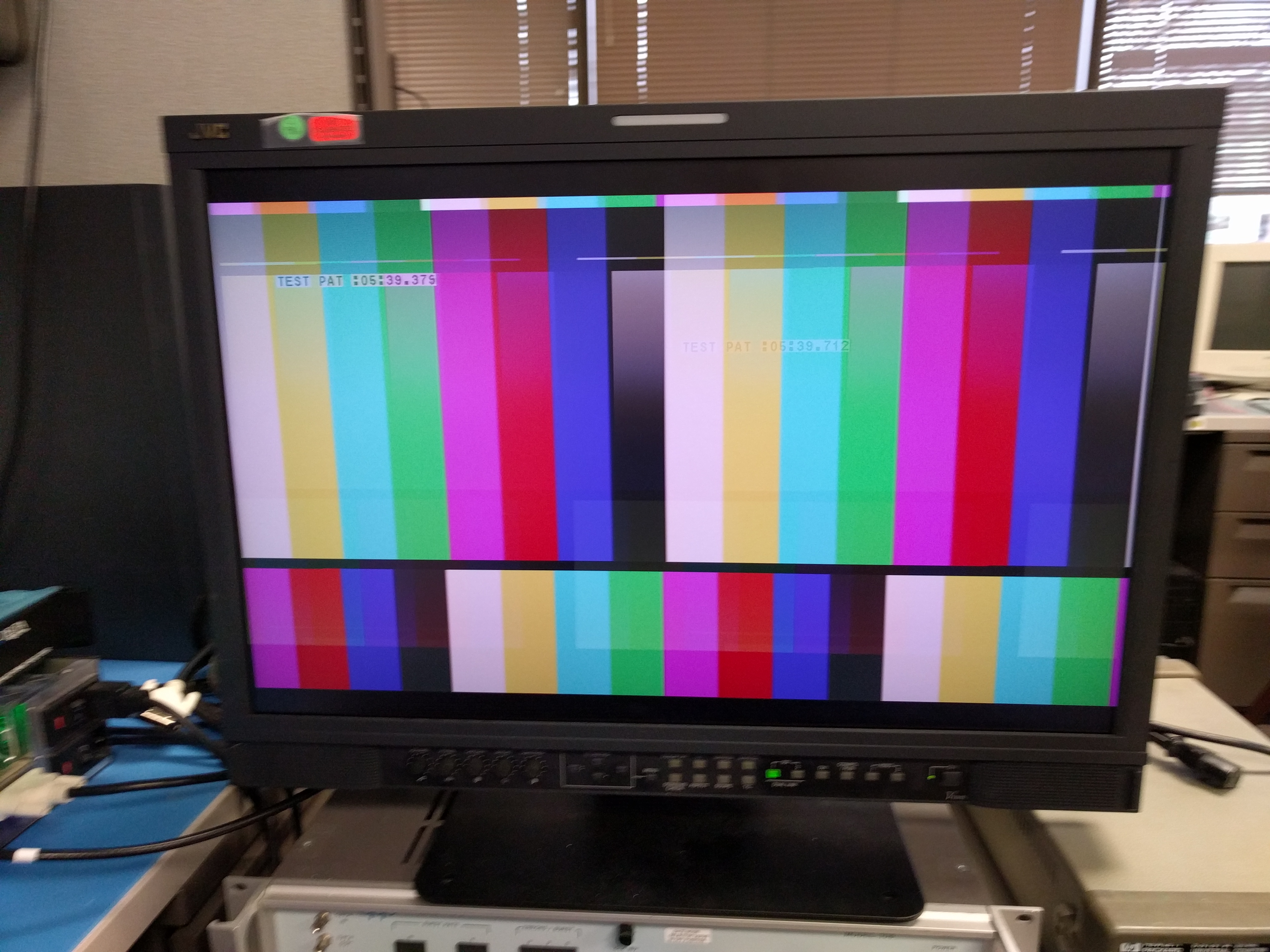

    Another shot of the same, for reference:
    In this mode, our reference monitor does lock to and stay stable at 720p59.9.  It's difficult to see with static images, but the video itself is not stable.  Because the monitor itself is staying in sync, I'm assuming the VENC timings are mostly OK.

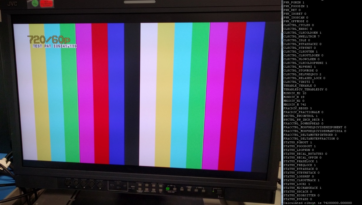

    Here's a shot with clock at 74.2 MHz.  This is the way the driver released from TI sets the clock when the resolution is set to 720p59 or any other format where 74176 khz in ti_vdis_timings.h.  As with the previous picture, PLL settings are superimposed to the right of the monitor.
    The image is stable in this shot, but the reference monitor detects 720p60 when it should be 720p59.9.  This happens because the pixel clock is too far away from 74.25/1.001 MHz, at 74.2MHz.  The reference monitor will actually reset and switch between 720p59 and 720p60 at irregular intervals every few seconds.
    So, the video is broken in the unmodified code because the pixel clock is too far from the specified 74.25/1.001 Mhz, causing confusion in our reference monitor and some of our other products.  The video is broken in our code because changing the clock somehow causes the image to become unstable.  The PLL values are the only things that change between versions, so I'm a bit stumped as to where the problem might be.
