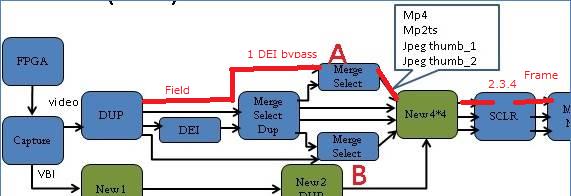

    If we want to use SC5 to do that...
    Plz refet to our architecture as below and focus on red color path.
    If input is 1920x1280 59.94i, then go through by Merger/Select/New4(a new disign component) -> SCLR.
    If we hope: after SCLR, the output will be 1920x1280 29.97p with weaving mode.
    How to set SCLR to support it?
    I think it should be not so easy to just configure SCLR to support weaving mode.
    Could you give some reference code or how to achieve it?
    thx ~
    HB
  • Hi HB,
    We dont have reference code to do exactly what you want.
    Scalar does not have special mode to support weaving mode, You need to set the SCLR in bypass mode or 1x scaling mode, so that scalar outputs is same as input and then update the output buffer addresses such that both the fields are stored in interleaved mode.
    Rgds,
    Brijesh
