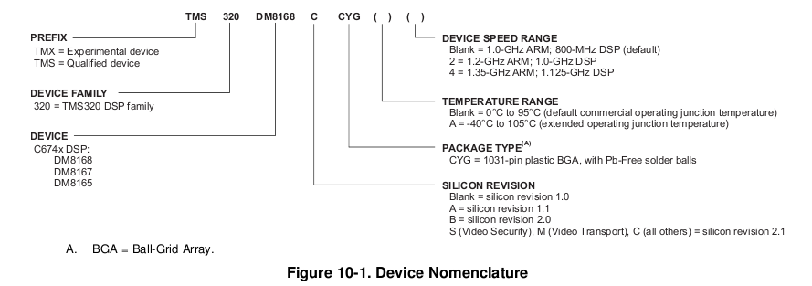

I am using the latest EZSDK, 5.03.01.15 for DM816x/ AM389x board. Previously I have used the part number TMS320DM8168BCYG2. Currently I am using TMS320DM8168CCYG2 part number with the same EZSDK. Seem only the silicon revision is changed with chip revision. In this case, my system is not at all booting.
So please suggest any solution to solve this issue and also I want to know what are changes needs to be done in the Software for new silicon revision chip.
Thanks in advance.
  • Hello Muhammad,
    The only difference between TMS320DM8168BCYG2 and TMS320DM8168CCYG2 is that the first one is silicon revision 2.0 and the second one is 2.1
    The difference between 2.1 and 2.0 are described in the DM816x silicon errata document.

    DM816x u-boot has PG2.1 support with this patch:
    http://arago-project.org/git/projects/u-boot-omap3.git?p=projects/u-boot-omap3.git;a=commit;h=ca8a79a7462192d92106673fe4d62d48aee05624
