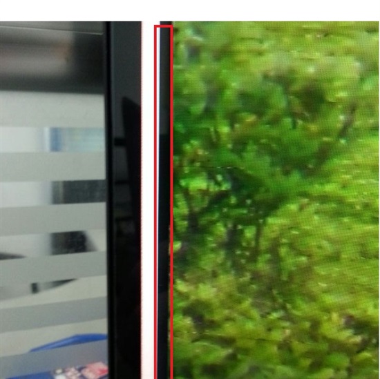

    I use custom DM8168 board. have one tvp7002 used to capture 1080I60 ypbpr picture.
   I connect the camera to a monitor , seems the picture is ok.
   I store the yuv capture from the captureLink and store the h.264 stream file from the venc. all of them have about 12 column pixels is error.

  • Hi Eason
       Thanks for reply.
       The area in  the red rect is the error black area. the white in the left side is of  yuv player.
       I will show the correct image later, because now the monitor is used by other people..
  • Hi  Eason
      the right.jpg is the picture show in a monitor. i take this photo by mobilephone.
     the black_edge.jpg is capture by dm8168 vip0.
  • OK.... finally I think I understand your question.
    Try the AVID start/stop   registers in TVP7002.
    The value stop-start should not exceed the total active pixel number , otherwise the image might disappear.

  • Hi Eason
       I set the AVID start Pixel of addr 0x40-0x41 as 0x0106.  AVID stop pixel as 0x088a.
       Use the new value ,the left edge of picture have real pixel but a green rect. conver on it  and the right edge of picture have black rect.

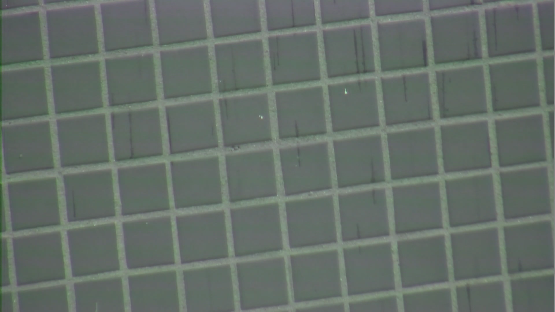

  • Hi Eason
      I can't open  http://www.ti.com/lit/zip/slec029.
      I tried other ypbpr camera, all have same problem.
      my register value and the issue image.
      i change the AVID start pixel and AVID stop pixel, and the right edge didn't have black edge , but still not correct pixel.
