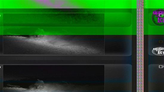

I use OMX to transcode video streams to h264. MPEG2 SD input streams looks ok, but h264 FHD looks like on picture below.
What parameter could be a reason of this?

    This frame it seems double. Could you check the output of the mpeg2 decoder component or on the input of the h264encoder component?
    Margarita

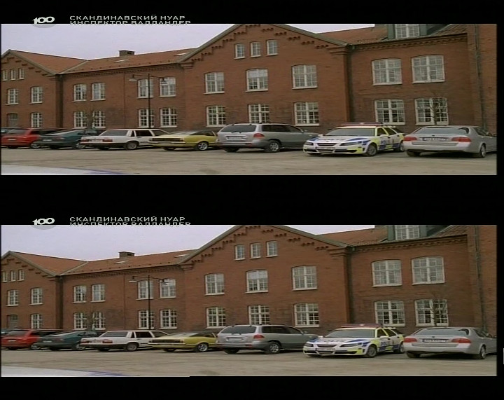

  • Video is interlaced. Pipelines: mpeg2(dec)->h264(enc), h264(dec)->h264(enc)
    Here is gdb output below with port defenitions.  The first pipeline works, but the second doesn't.

    I meant also to grab the frames between components to check is it correct and between which two elements is broken.
    Margarita
  • Margarita,
    I don't use DEI. If input video is mpeg2, encoder output is correct.

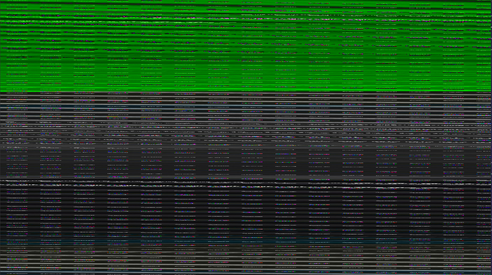

    This is decoder output frame.

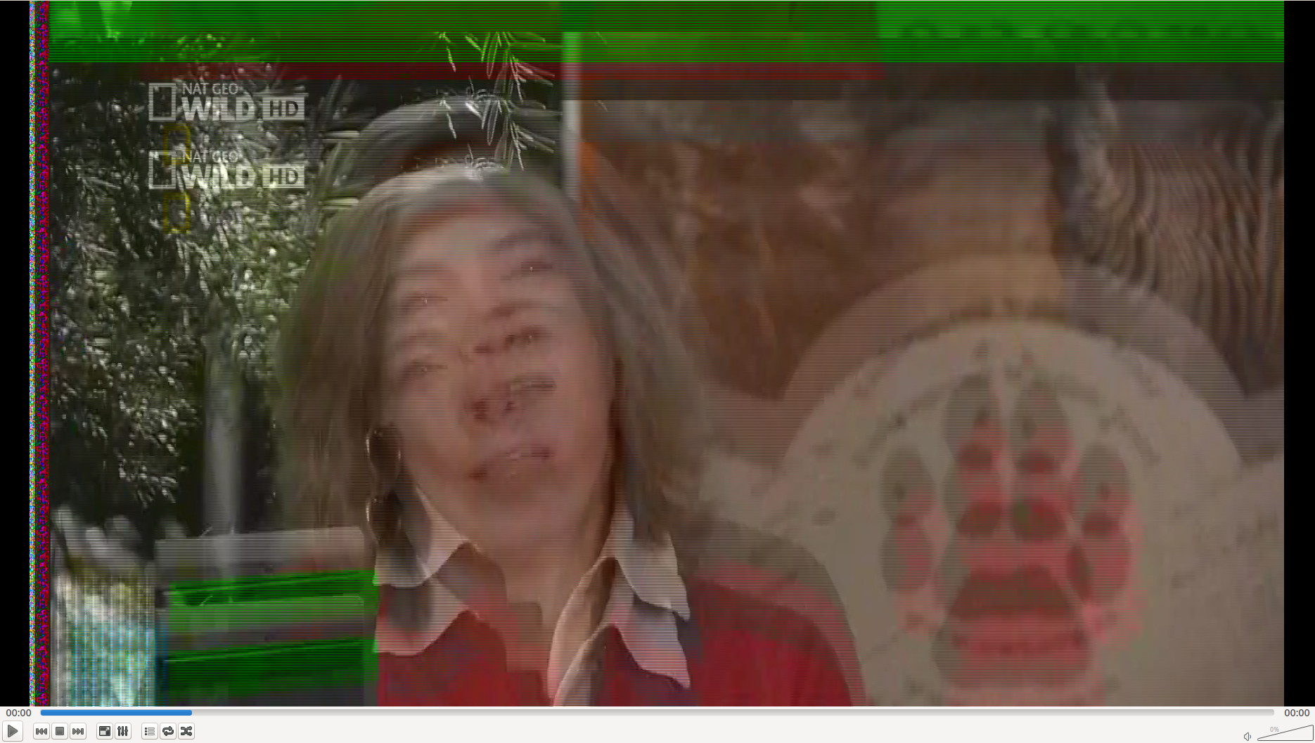

    This is encoder output frame.
    this is h264 decoder output played with params: nv12 1920x1080
    nv12 2048x1080
    I guess something wrong with decoder output port definition.

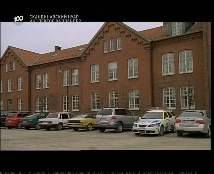

  • This is a original frame from the test h264 progressive video.
    This is a transcoded frame. It seems that the picture is shifted in the buffer. Could you please provide the correct ports configuration for h264dec and h264enc components?
  • Stupid mistake. I didn't take into account the buffer offset. So the garbage was written.
