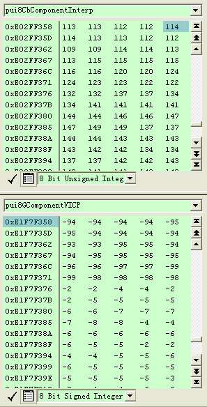

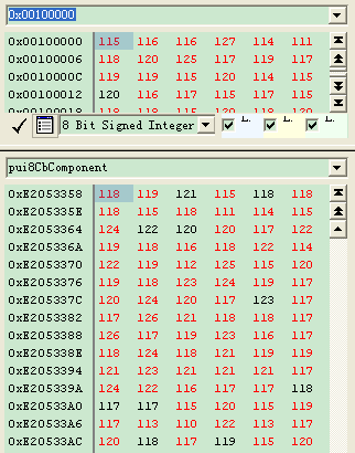

Hi,  I used the DM648 chip and call the VICP library function: CPIS_colorSpcConv( ) Func, However I find the function has some problems, my code is that:
Int16 g_VICP_iCoeffMatrix[9] = {0, 0, 0, 0, -401, 0, 0, 0 0}; //系数矩阵
Int16 g_VICP_i16PreOffset[3] = {0, -128, -128}; //运算前输入加上的值
Int16  g_VICP_i16PostOffset[3] = {0, 0, 0}; //运算后输出加上的值
Int16  g_VICP_i16SignedInput[3] = {0, 0, 0}; //输入数据符号
Int16  g_VICP_i16SignedOutput[3] = {0, 0, 0}; //输出数据符号
Uint32 g_VICP_ui32QShift = 10; //结果左移10位
SpacConvBase->srcFormat[0] = CPIS_YUV_444P;
SpacConvBase->srcBuf[0].ptr = pui8YComponent;
SpacConvBase->srcBuf[0].stride = iWidth;
SpacConvBase->srcBuf[1].ptr = (char*)pui8UComponent;
SpacConvBase->srcBuf[1].stride = iWidth;
SpacConvBase->srcBuf[2].ptr = (char*)pui8VComponent;
SpacConvBase->srcBuf[2].stride = iWidth;
SpacConvBase->dstFormat[0] = CPIS_RGB_P; //
SpacConvBase->dstBuf[0].ptr = pui8RComponent;
SpacConvBase->dstBuf[0].stride = iWidth;
SpacConvBase->dstBuf[1].ptr = pui8GComponent;
SpacConvBase->dstBuf[1].stride = iWidth;
SpacConvBase->dstBuf[2].ptr = pui8BComponent;
SpacConvBase->dstBuf[2].stride = iWidth;
SpacConvBase->roiSize.width = iWidth;
SpacConvBase->roiSize.height = iHeight;
SpacConvBase->procBlockSize.width = g_VICP_ui32BlockWidth;
SpacConvBase->procBlockSize.height = g_VICP_ui32BlockHeight;
SpacConvBase->numInput = (iWidth * iHeight);
SpacConvBase->numOutput = (iWidth * iHeight);
SpacConvParams->matrix[0] = g_VICP_i16CoeffMatrixff[0];
SpacConvParams->matrix[1] = g_VICP_i16CoeffMatrixff[1];
SpacConvParams->matrix[2] = g_VICP_i16CoeffMatrixff[2];
SpacConvParams->matrix[3] = g_VICP_i16CoeffMatrixff[3];
SpacConvParams->matrix[4] = g_VICP_i16CoeffMatrixff[4];
SpacConvParams->matrix[5] = g_VICP_i16CoeffMatrixff[5];
SpacConvParams->matrix[6] = g_VICP_i16CoeffMatrixff[6];
SpacConvParams->matrix[7] = g_VICP_i16CoeffMatrixff[7];
SpacConvParams->matrix[8] = g_VICP_i16CoeffMatrixff[8];
SpacConvParams->qShift = g_VICP_ui32QShift;
SpacConvParams->preOffset[0] = g_VICP_i16PreOffset[0];
SpacConvParams->preOffset[1] = g_VICP_i16PreOffset[1];
SpacConvParams->preOffset[2] = g_VICP_i16PreOffset[2];
SpacConvParams->postOffset[0] = g_VICP_i16PostOffset[0];
SpacConvParams->postOffset[1] = g_VICP_i16PostOffset[1];
SpacConvParams->postOffset[2] = g_VICP_i16PostOffset[2];
SpacConvParams->signedInput[0] = g_VICP_i16SignedInput[0];
SpacConvParams->signedInput[1] = g_VICP_i16SignedInput[1];
SpacConvParams->signedInput[2] = g_VICP_i16SignedInput[2];
SpacConvParams->signedOutput[0] = g_VICP_i16SignedOutput[0];
SpacConvParams->signedOutput[1] = g_VICP_i16SignedOutput[1];
SpacConvParams->signedOutput[2] = g_VICP_i16SignedOutput[2];
SpacConvParams->colorDsMode = g_VICP_ColorDsMode;
the formula is:
R = 0*(Y - 0) + 0*(U - 128) + 0*(V  -  128)
G = 0*(Y - 0) + 0.392*(U - 128) + 0*(V - 128)
B = 0*(Y - 0) + 0*(U - 128) + 0*(V  -  128)
the result show blow:
the first data of Cb is 113, the difference between it and 128 is -15, and the -15*( -0.392), the result  is 6, however the result is -94. I suppose the compiler execute 113-128, the result is 67.
I hope you can reply as soon as possible, thanks!

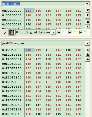

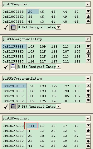

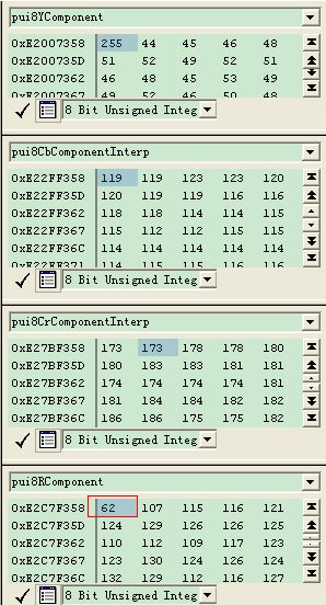

    I try again in accordance with your reply, however I find the last result have negative number, and VICP don't clear it to zero.
  • Hi, I find in the _colorSpcConv.c have a line is that:
    info.cmdlen+=imxenc_set_saturation(255, 255, -256, -256, info.cmdptr + info.cmdlen);
    It set the sat_low is -256, however the last result may be the Uint8 type.
    And then I set the info.cmdlen+=imxenc_set_saturation(255, 255, 0, 0, info.cmdptr + info.cmdlen) before the info.cmdlen+= imxenc_color_spc_conv()
    I find the data which less than 0, to be set 0
    However the data which greater than 255, to be set the (data - 255)
    for example:
    I don't understand that, can you tell me the reason?
    Thank you!

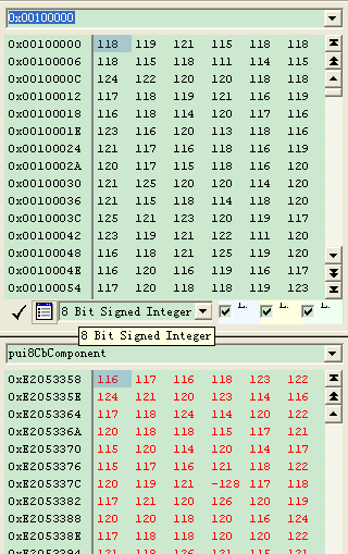

    Can you try to use the natural C version GPP_CPIS_colorSpcConv() and see if you can modify it to produce the desired results.  Once you get the correct results with GPP_CPIS_colorSpcConv(), please send it to me and I can try to fix CPIS_colorSpcConv().
  • Hi.
    Thank you for your reply and I try again in accordance with that.
    I find some bugs and modify the code, as follows:

    /****************** add code ******************/
    highSat = 255;
    setHighSat = 255;
    lowSat= -256;
    setLowSat= -256;
    /***************** add end ********************/

    //*((Uint8*)infoSrc.comp[i] + j)= (Int8)C0;
    *((Int8*)infoSrc.comp[i] + j)= (Int8)C0;
    /************ add the code ************/
    highSat = 255;
    setHighSat = 255;
    lowSat= 0;
    setLowSat= 0;
    /************ add end ***************/

           The VICP address 0x00100000 data and the U component is show in the picture
    and then I run the program and I find the U data is forer than the 0x00100000 some circle.
    Three days passed, if you have some suggestions for me.
    For us, this is demand very urgent.
    Thank you!

    Thank you for your reply.
    My problem is that, the last result of R,G,B have negative data, and VICP's sat_low_set = -256, so the negative would be a very large positive data, for example:
    if the G = -16, VICP's result is 240.
    My result figure would have many noise points.
                                                        error image
                                                                               normal image

  • Hello Victor, Thank you for your reply.
    There are problems either with your suggestion or my  own formula.
    I have tried your suggestion three days ago, however I found the G,B component is corrected, and the R component is incorrect.
    the R component is beyond the 255, vicp will set it to R-256, for example the R = 320, the result is 320-256=64.
    Could you please contact your local FAE for further assistance ? Thanks.
