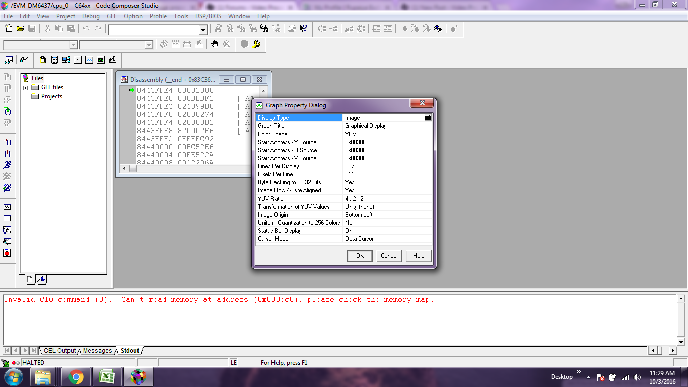

  • Hi Kartheek,
    I have generated .out file in ccs6.1 and i loaded that .out file in CCS3.3.Am not getting where to do all the settings as you told about pointers and where to add the input file.
    "Use the pointers *yIn, *cbIn, *crIn in the image window in CCS. Select YUV420 format. Download any QCIF (176*144)YUV video from
    and provide that as input to this program".......
    when i open the graph and image ,it was showing this settings as shown in attachment.....but not getting where to do pointer settings and when i run the program,it was showing "cant read memory at the adress,change the address.........requesting to sort it out.

  • You can fill the window with the following details
    Start Address - Y Source - yIn
    Start Address - U Source - cbIn
    Start Address - V Source - crIn
    Lines Per Display - 144
    Pixels Per Line - 176
    Byte Packing to Fill 32 Bits - No
    Image Row 4-Byte Aligned - No
    YUV Ratio - 4:2:0
    Image Origin - Top Left
  • Add a breakpoint towards the end of the main() function or at the end of the for loop and refresh the image window. Your input image will be displayed in the image window. For more details you will have to learn about image and video color space basics.
  • Hi Kartheek ,
    thanks for your support,i know something about image and video processing as i did on OMAPL137/138,but i have not done on DM6437 and in CCSv3.3.
    i am only following the steps what and all you are telling,i did that configuration but i got like this..........see the attachment ........how to overcome from this.
