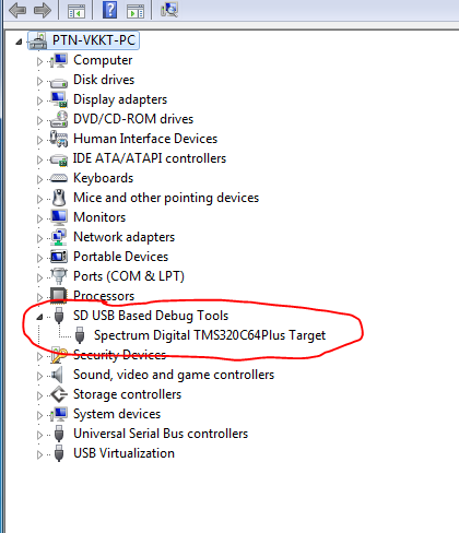

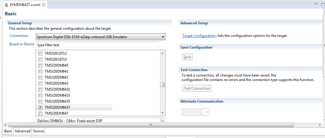

  • Problem with CCS 6.1.1 wit EVM DM 6437 kit
    Dear all,
    I install CCS 6.1.1 , anh use with EVM DM6437 kit, I cannot test PC connection to Kit,  though, I can see Spectrum Digital Probe in Device Manager as following photos
    Please help me
    Many thanks for your support
    Detected in Device Manager
    Test Conection is dimmed in CCS 6.1.1
