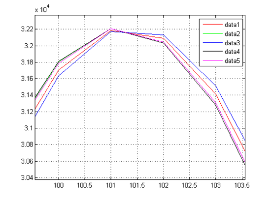

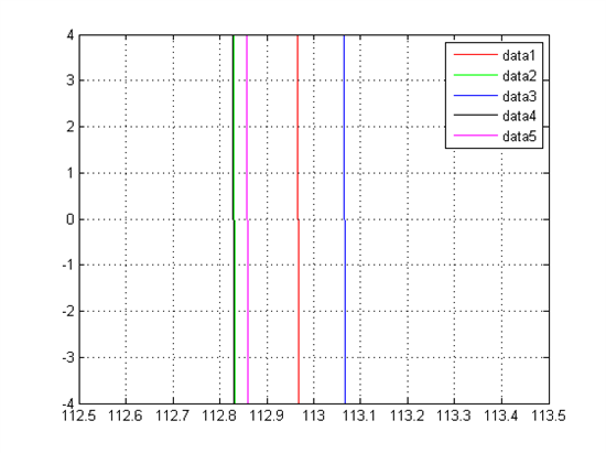

Even if, between reading the buffer where the sample is saved (MCASP1_RBUF0_32BIT) and writing it to the output buffer, I don't do any elaboration (I just "copy paste" it exactly as I do for the right channel), I still can observe, with an external oscilloscope, that there is a lag of approximately 40 samples between what is being input in the board and what the board is outputting (i.e., which is, again, just a copy of the input signal).
I have also observed that the output gets inverted in polarity, but this is not a huge problem.
Where does this Lag come from? I guessed it was due to some filter in the ADC/DAC process but wasn't able to find much in the AIC3106 manual.
