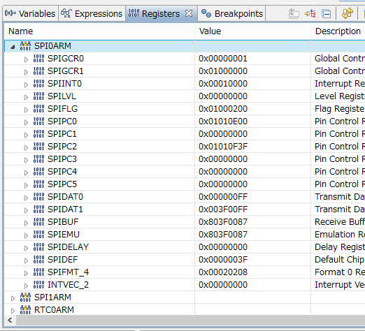

    I forgot to write an important point in the previous post.
    I am using 3-pin spi slave mode. So I suppose that condition on SPIx_ENA / SPIx_SCSn pins does not matter. Is this correct?
    Here is a pic of SPI registers just after this problem occurs:
    It would be helpful if any comments on the register settings.
    I think that signal integrity is most possible cause in this case. But I have not seen any fault in signal swinging level, slew rate and rising/falling edge counts so far. I believe that the SPI master drives spi clock correctly in its signal quality and its count. Problem should be in SPI slave side.
    Anyway, I am going to check carefully each of what you pointed out and I will post again if I find something new.
