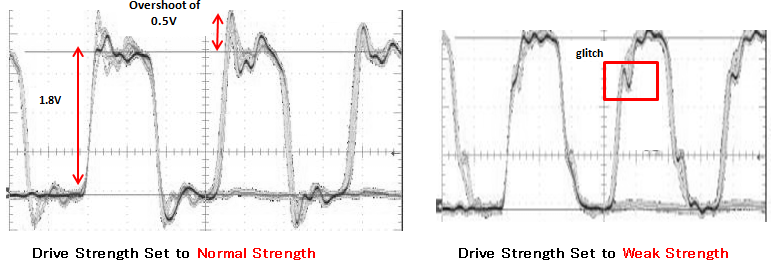

    Meanwhile we have received below waveform measured on the DQS1 line,
    with Drive strength set to Normal and Weak.
    As shown below, with Normal strength there is a overshoot of
    0.5V and with weak strength there is a glitch in the rising edge of
    the signal.
    We need your advice on selecting the Drive Strength in this case.
    As the customer board is into Mass production we don't have the option to
    re-design the board.
    Could you please let us know your comment on the below two options.
    1.Weak strength.
    With weak strength there is a glitch in the rising edge as shown above.
    Could you please let us know if this kind of glitch is a general issue
    and if it can be ignored
    2.Normal strength.(Can we choose this option?)
    Is it OK to continue with the 0.5V overshoot.
    As per the datasheet it is mentioned that AM1808's DDR2 I/O adhere to the JESD79-2A standard
    and according to the JESD79-2A standard the overshoot can be upto 0.9V.
    So we believe 0.5V overshoot is under the JESD79-2A standard.
    Prad.
  • Hello Prad,
    The observation of non-monotonic signal when the drive strength is weak might be due to probing issue.
    It is very difficult to place an oscilloscope or logic analyzer probe on signals under DDR package. When probing on other locations, the signal measured is not representative of the signal at the DDR. If a non-monotonic signal or noise is observed at those locations, the signal observed at the DDR will be different.
    Moreover, you were mentioned that the system crashes when using weak drive strength. And the overshoot measured on normal drive strength is well within the limits of JESD79-2A standard. Given the benefit of doubt, it would be better to go ahead with normal drive strength.
    Senthil

    Below is our current understanding about the issue,
    could you please let us know if there is any comment on the below understanding.
    1. As mentioned(in the above figure) there is a glitch in the rising edge with the Weak strength
        and we have the system crash issue with Weak strength.
    2. With Normal strength there is no glitch in the rising edge and there is no system crash issue.
    So the conclusion is the glitch disappears with Normal strength.
    According to your comment we understand this might be a Probing issue,
    but we also believe this could be because of the signal integrity issue, Signal reflection etc.
    (As this board doesn't use any ODT or any external termination(series))
    We are trying to analyze what could be the reason for the glitch other than probe
    and why does it disappear with Normal strength.
    Prediction:
    Generally, a higher drive performance means a faster signal transition time (rise time or fall time)
    which is faster than than the DDRx Signal reflection time, so the rising signal is not disturbed compared
    to Weak strength (i.e the glitch won't be there with Normal strength).
    Please let me know if this Prediction is correct?
    Best Regards
    Prad

  • Hi Senthil,
    Thank you.
    As mentioned in the wiki page
    "When no terminators are used, the memory should use weak drive strength"
    This is our case, even though the design is as per the datasheet routing rules
    we are gettings the memory issue.
    And we understood that "For designs without terminators on the bus, higher drive strengths may be used"
    but trying to understand how could higher drive strengths solve the memory issue?

  • Hello Prad,
    Sorry for the late response.
    The DDR2 interface without any terminator is supposed to work normally in weak drive strength. But you are seeing glitches and system crash which means there is a design issue in your board.
    For designs without terminators on the bus, higher drive strengths may be used given that the JESD79-2E  overshoot requirements are still met. Overshoot that is above the specification may result in reliability issues over time.
    The DDR2 JESD79-2E specification for over shoot and undershoot limits are VDD+0.5V and VSS-0.5V (Figure 75 & 76). If your over shoot/undershoot is within these limits, you are good to go with normal drive strength.
    Please refer below wiki page for drive strength settings..
    http://processors.wiki.ti.com/index.php/DDR_Interface_Drive_Strength
    The drive strength on the memory module typically controls the output impedance. When you are using normal drive strength, the output impedance is decreased to drive more current. In this scenario, there will be a mismatch in driver impedance and trace impedance and this causes reflections in the transmitted signal. In your board, the reflections appears due to mismatch in trace impedance and driver output impedance in normal drive strength. To avoid or minimize this reflections, terminations will be used.
    Since you freezes the design, you can go for mass production "provided the reflections are within JESD79-2E specified limits".
    Disclaimer: We cannot guarantee that the boards would work reliably through out the life span. The reflection level might change from board to board due to impedance tolerance.

  • Hi Senthil,
    Thank you very much for the comments.
    Regarding the below comment by you, is this a typo?
    do you mean to say Weak Drive Strength?
    "The drive strength on the memory module typically controls the output impedance. When you are using normal drive strength, the output impedance is decreased to drive more current. In this scenario, there will be a mismatch in driver impedance and trace impedance and this causes reflections in the transmitted signal. In your board, the reflections appears due to mismatch in trace impedance and driver output impedance in normal drive strength. To avoid or minimize this reflections, terminations will be used. "
    I believe we can assume the singnal reflections would be decreased with stronger(normal) drive strength
    and hence the memory issue is solved with stronger(normal) drive strength.
    Best Regards
    Prad
  • Hello Prad,
    There was no typo in my statement.
    I meant to say normal drive strength only. In this mode, to drive more current, the output impedance will be reduced and not increased.
    In your case, if you see the above posted waveform, the weak drive does not have any reflections whereas the normal drive strength has reflections. The cause is solely dependent on the trace impedance and driver impedance.
    I guess your system works fine with normal drive because of not having non-monotonic behavior. Also the reflections might be well within the limits.
    Senthil

  • Hi guys,
    Please find the below feedback from the engineers at the customer on remaining questions:
    Senthil has raised several points. These were valid points, and the feedback was qualitatively high. Regardless, in my opinion, the root cause has not been sufficiently established yet, because:
    "The observation of non-monotonic signal when the drive strength is weak might be due to probing issue."
    This is factually correct. But we took care of that by cross-referencing the observed signal with additional SI simulations correlating the signal on the measurement point with the signal observed at the memory device. The differences were neglible, and we are confident that the observed signal is a very good proxy for the signal at the memory device.
    "I believe, the system crash is mainly due to timing violations. "
    Reasonable assumption in general. Probably the first thing that comes to mind when faced with such an issue. Yet, SI clearly showed absolutely no evidence what-soever of any timing violation. This is corroborated with actual measurements.
    "But you are seeing glitches and system crash which means there is a design issue in your board."
    This conclusion is premature, and unsubstantiated. "You see a problem. Therefore, you made an error."
    If there is a design issue with our board, we must be able to point our finger at the exact problem thats causing this. We couldn't, and our external SI experts also couldn't.
    Another possibility is that there is an as yet unknown issue with the DDR controller in the MPU itself, that our board brings to the surface. Only we see this, because everybody else is using termination resistors without second thought.
    "The customer must have been followed the DDR design and layout guidelines provided in the device datasheet for proper operation. If they neglect any of the recommendation, chances are high for system crash issue."
    Again, a general statement. Please back up with actual facts: which recommendation did we neglect? We would like to know.
    "Senthil and team had gone above and beyond to help. Including offline review of their layout + schematics and highlighted several violations on the DDR layout , not complying to the datasheet specifications"
    Yes, I really appreciate that. However, KTL send the layout/schematics to Senthil, but the conclusions were not shared on E2E, so I cannot comment on them.
    (1)
    If Senthil/TI has any layout/schematic recommendations, based on previous analysis, please share directly with us. Those conclusions are not shared on E2E.
    If you have any such review or conclusion from Senthil's team, please share it with us as soon as possible!
    (2)
    The "glitch" is our prime suspect. JEDEC standard mentions that during the transition region on the rising edge, the signal must be monotonically rising. The glitch could be a violation of this condition. However, the glitch is above the maximum threshold where the signal should be monotonically rising, according to the JEDEC standard. So, we are in spec.
    However, could the AM1808 be more sensitive to these kind of glitches, and operate slightly out of spec?
    If so, would that cause the behavior we are seeing? I.E., resetting MPU DDR2 controller resolves the memory problem, the memory is stable and not fluctuating, and not corrupted.
    (3)
    It is mentioned that "the reflection level must have been maintained within JESD79-2E limits". Is spec also applicable for the MPU? i.e. the overshoot is only on the MPU (receiving) side, because it is the DDR2 memory device that is increasing the drive strength.
    I think we need to make absolutely sure now that our devices don't end up with shortened life-spans somewhere down the road.
    Thanks in advance for your help
    Kind regards,
    Louka
