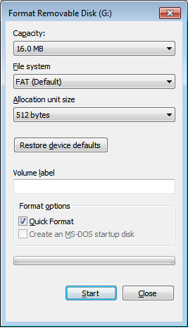

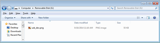

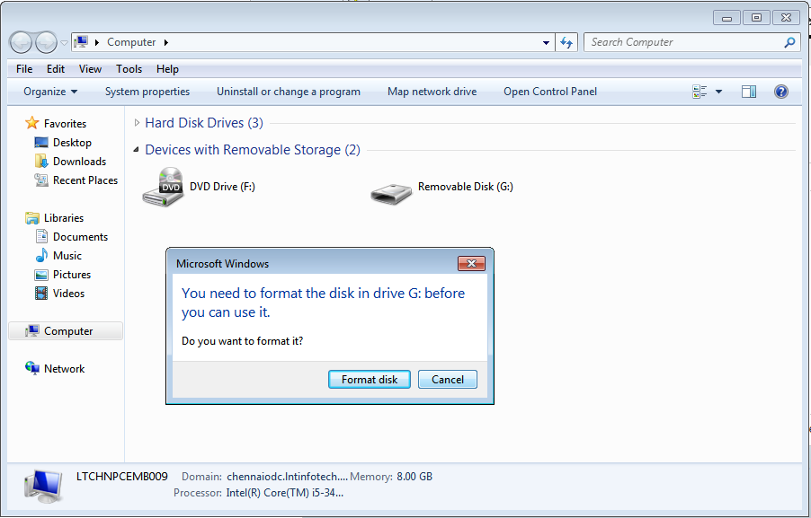

  • Hi saeideh,
    If it is a mass storage device, usually any host PC like WIndows / Linux will have an in-built standard usb host driver to recognize the mass storage device(i.e., OMAPL137).
    Once you run the usb_dev_msc program on OMAPL137 board, it will act as a mass storage device. And, when you connect to the host PC, it will display it as a removable media. You can format with FAT filesystem and use it as a removable medium for transfering files to the ram disk of OMAPL137.
    Please refer the screen shot of OMAPL138 (configured as USB mass storage ),  hooked into the WIndows machine
    and recognized as a removable media.
    Once you format, you can transfer the files. But note, that the storage medium used is RAMdisk, so when you power off the board, you will loose the file/data. you can use the transferred file until you power off the board.
