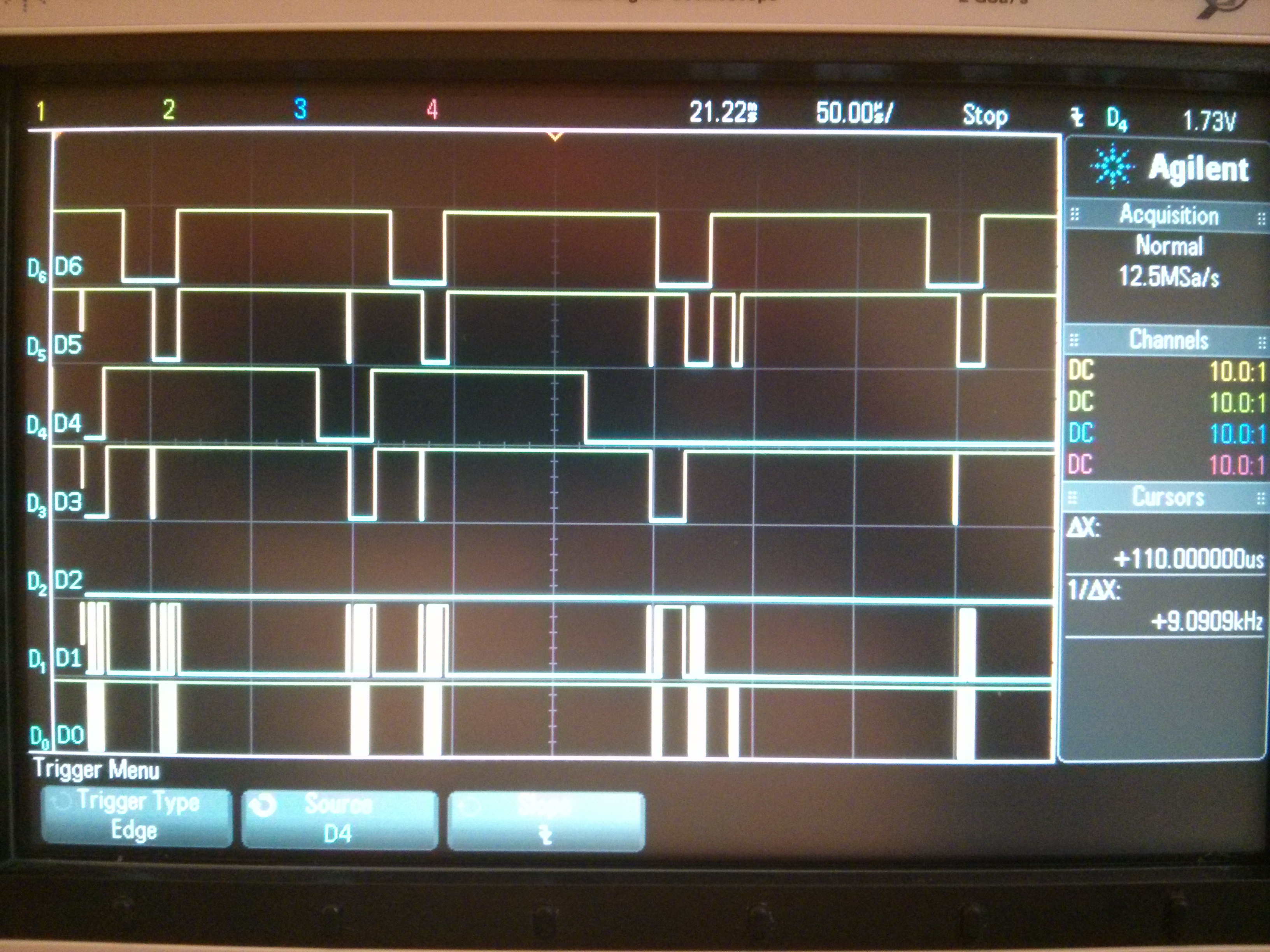

Hello All,
I am using LogicPD Omap L138 SOM on a custom board, SysBios 6.34.2.18, XDCTools 3.23.5.61, StarterWare 1.10.03.03.
I am trying to communicate with two sensors trough SPI0 bus (different CS) over the ARM9 core.
SPI freq is between 1.25Mhz to 10Mhz (the problem remains the same).
The sensors protocol is as follows:
1. GPIO trigger indicated that data can be read,
2. When data is ready bring CS down (ACTIVE state)
3. Read  2 words (16bit each) from the bus.
4. Wait for 1.

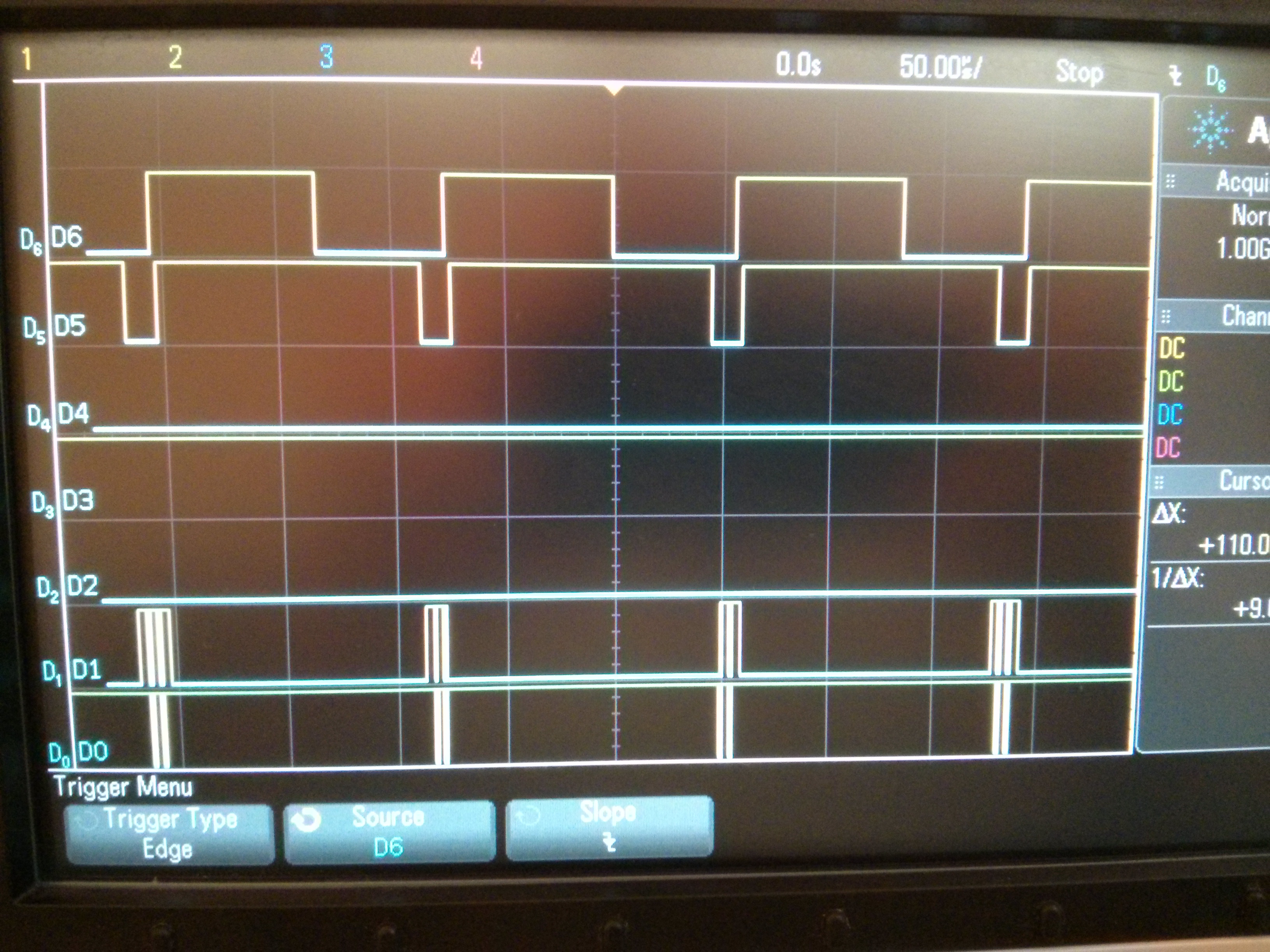

When working with only one device, this works perfectly but when I add the second device here's what happens:
After several milliseconds of good communication with both sensors, one of the devices interrupt occurs before the other finished sending the data so it takes over the CS line and this is the end for the first device communication and the second keeps on running.
Here is the device protocol:
Here is an image from the logic analyzer when things goes sour:
(D0-SCLK, D1-SOMI, D2-SIMO, D3-CS4, D4-VD4, D5-CS5, D6-VD6)
You can see here that D4 doesn't go HIGH anymore and that D5 interrupts D3 in the middle of the communication (Only 1 word was transferred).
I tried using Gate HWI but I keep missing interrupts and the data is corrupted.
I don't know how to make D5 wait for D3 to finish, I tried making D3 finish the job before\after D5 work, that makes D4 go HIGH again but I miss interrupts again and the data is corrupted.
Here is some of my code (consider it working compiled code):

The devices are a black box and cannot be changed, I can start the streaming at different times but eventually the same thing happens.
Why is it taking 15us for the SPI to start the transfer after the GPIO trigger (I checked and the code doesn't take so long)?
Sorry for the long post but I'm really frustrated so I would appreciate your help.
Yoel

  • Hi Yoel,
    Would you please post your interface diagram for SPI communication?
    Shankari
  • Hi Shankari,
    What do you mean by interface diagram?
    Yoel
  • Hi yoel,
    Would you please post the portion of your schematic diagram which contains the interface of Sensor devices with the processor.
    Shankari
  • Do you mean the electrical schematics?
    This is my schematic but instead of SPI1 lines, I changed it to SPI0:
    Yoel
  • Hi Yoel,
    To find that the transaction with the slave device is completed, we can consider checking the values of "CSNR fields" of 'SPI Data Register 1' and then start the communication with the next sensor.
    While configuring SPI, did you use "SPI Delay Register" and set C2TDELAY field?
    Shankari.
  • Hi Shankari,
    As you can see in my code, commented, is my try to find out if the other device is in the middle of communication (I check the SPIPC2 registers, is that wrong?) My problem there is that I don't know how to wait untill the end of the communication (This is HWI so I can't call Task_sleep and I can't ignore this call because I will miss it).
    I did play a little with the delay function but right now it is set to zero and the delay happens between the GPIO ISR and the Active state of CS, not between the CS down and start of communication, in other words, my question is, How can I make the GPIO interrupt fire the ISR without delay?
    Yoel
  • Yoel,
    Can you please specify your SYSBIOS setup for the code. I understand you have GPIO ISr as the HWIs.  Also specify the priorities assigned. The setup is complicating matters as it is connected to the same SPI on a different chipselect
    It seems like you need a more efficient way to handle your interrupts but there would still be possible to have data corruptions because you are sharing same piece of hardware.  Is there any reason you choose to use both the sensors on the same SPI and with different chip selects. Having them on different SPI could help you avoid this conflict.

    As you can see in the image below, the time it takes between the VD (GPIO ISR) to the CS active is almost 50us, all it has to do is release from the Semaphore pend.
    Changing the Hwi didn't solve the problem.
    Yoel
  • OK, I somehow made SPI1 work correctly with the sensors and now I have each sensor on a different SPI bus.
    But, the problem remain the same... At some point for one of the devices (not always the same one) the MCU takes a long time to do the transmission and the device stops streaming data. It's really weird, they don't share the same resources except for the ARM processor and they still can't work together...
    Any ideas?
    Yoel
  • Hurray!!!
    I switched to xdctools_3_24_07_73 and bios_6_35_04_50 and it solved the problem.
    Don't know why...
    I will try again with both sensors on SPI0 bus to see if the problem is solved there too and give an update.
    Yoel

    	 * NOTE: GP2[15] <-> J5p6 <-> SENSOR #1p10-VD, set PINMUX5, bit #3: {GP2[15],I/O}
    	HWREG(SOC_SYSCFG_0_REGS + SYSCFG0_PINMUX(5)) |=	0x00000008					;
    	/* force GP2[15] as input													*/
    	GPIODirModeSet(SOC_GPIO_0_REGS, SENS0_VD_PIN, GPIO_DIR_INPUT )				;
    	/* force GP2[14] as input													*/
    	GPIODirModeSet(SOC_GPIO_0_REGS, SENS1_VD_PIN, GPIO_DIR_INPUT )				;
    	/* Configure rising edge and falling edge triggers on pin GP2[15]
    	 * to generate interrupt													*/
    	GPIOIntTypeSet(SOC_GPIO_0_REGS, SENS0_VD_PIN, GPIO_INT_TYPE_FALLEDGE) 		;
    	/* Configure rising edge and falling edge triggers on pin GP0[09]
    	GPIOIntTypeSet(SOC_GPIO_0_REGS, SENS1_VD_PIN, GPIO_INT_TYPE_FALLEDGE) 		;
    	/* Performing the Pin Multiplexing for SPI #0:
    	 * enable pins: {SPI0_CLK, _SPI0_SIMO, SPI0_SOMI, SPI0_ENA} 				*/
    	SPIPinMuxSetup(0)															;
    	/* select Chip Select(CS) 5 of SPI0											*/
    	SPI0CSPinMuxSetup(SENS0_CS)													;
    	/* select Chip Select(CS) 4 of SPI0											*/
    	SPI0CSPinMuxSetup(SENS1_CS)													;
    	/* Configuring and enabling the SPI1 instance. 								*/
    	//SetupSpi()																	;
    	SetupSpi(SENS0_SPI_BASE, (SENS0_CS_WRD | SENS1_CS_WRD))																	;
     ** Configures SPI Controller
    Void SetupSpi(unsigned int baseAdd, unsigned char dcs)
    	unsigned int	frmt_ind	= SPI_DATA_FORMAT0								;
    	// SPI0_CS[0x30]
    	/* reset state SPI0, SPI_BASE = 0x01C41000 (for SPI #0)						*/
    	SPIReset(baseAdd)															;
    	/* out of reset state SPI0													*/
    	SPIOutOfReset(baseAdd)														;
    	/* set SPI0 to MASTER_MODE and SPIx_CLK is configured to output				*/
    	SPIModeConfigure(baseAdd, SPI_MASTER_MODE)									;
    	/* set SPI_DATA_FORMAT0.PRESCALARE = (moduleClk/spiClk) - 1, other bits of
    	 * SPI_DATA_FORMAT0 are cleared.											*/
    	SPIClkConfigure( baseAdd		   		,
    			ARM_CLK_RATE_IN_HZ>>1	,
    			SPI_CLK_RATE_IN_HZ		,
    			SPI_DATA_FORMAT0 ) 										;
    	/* set SPIPC0 with val: CS#5 active, SPI0_ENA not active (GPIO),
    	 * {CLKFUN, SIMOFUN, SOMIFUN, ENAFUN} active 								*/
    	//SPIPinControl(SPI_BASE, 0, 0, &val)											;
    	HWREG(baseAdd + SPI_SPIPC(0))  = 0x0 										;
    	HWREG(baseAdd + SPI_SPIPC(0)) |= SPIPC0_SOMIFUN_MSK(1)						;
    	HWREG(baseAdd + SPI_SPIPC(0)) |= SPIPC0_SIMOFUN_MSK(1)						;
    	HWREG(baseAdd + SPI_SPIPC(0)) |= SPIPC0_CLKFUN_MSK(1)						;
    	HWREG(baseAdd + SPI_SPIPC(0)) |= SPIPC0_SCS0FUN_MSK(dcs)					;
    	/* set SPIDEF with dcs: CS#5 and CS#4 defualt "1" logic when inactive  		*/
    	SPIDefaultCSSet(baseAdd, dcs)												;
    	 * set SPI_DATA_FORMAT0.POLARITY = 1, SPI clock signal is high-inactive.
    	 * set SPI_DATA_FORMAT0.SHIFTDIR = 0, MSB shift out first.
    	 * set SPI_DATA_FORMAT0.CHARLEN  = 0x10, 16 bit shift register. 			*/
    	SPIConfigDataFmtReg(baseAdd, frmt_ind)												;
    	/* set SPI_SPILVL.TXINTLVL = 1, tx interrupt mapped to INT1.
    	 * set SPI_SPILVL.RXINTLVL = 1, rx interrupt mapped to INT1.				*/
    	SPIIntLevelSet( baseAdd,
    			SPI_RECV_INTLVL | SPI_TRANSMIT_INTLVL) 						;
    	/* set SPI_SPIPC1.SCS0DIR[4] = 1, SPI0_SCS[4] pin is an output.
    	 * set SPI_SPIPC1.SCS0DIR[5] = 1, SPI0_SCS[5] pin is an output.
    	 * set SPI_SPIPC1.SPIx_CLK   = 1, SPI0_CLK pin is an output.
    	 * set SPI_SPIPC1.SIMODIR	 = 1, SPI0 SIMO pin is output.					*/
    	//HWREG(baseAdd + SPI_SPIPC(1)) |= 0x00000600										;
    	/* set SPI_SPIGCR1.ENABLE = 1, Enable SPI0 communication. 					*/
    	SPIEnable( baseAdd )														;
     ** Get Data from slave
    void SPIReceiveData(unsigned int baseAdd, unsigned short length, short *buffer, UInt8 *read, UInt64 *idx)
    	int i;
    	for(i=0;i<length;i++)
    		while(!(HWREG(baseAdd + SPI_SPIFLG) & SPI_SPIFLG_TXINTFLG));
    		SPITransmitData1(baseAdd, 0);
    		while(!(HWREG(baseAdd + SPI_SPIFLG) & SPI_SPIFLG_RXINTFLG));
    		*buffer = (short)SPIDataReceive(baseAdd);
    	    buffer++;
    	    (*read)--;
    	    (*idx)++;
    ** Send SPI command to slave
    void SPISendCmd(unsigned int baseAdd, unsigned char cs, unsigned short command)
    //#if(USE_SPI_DMA == ON)
    	SPIDat1Config(baseAdd, (SPI_CSHOLD | SPI_DATA_FORMAT0), (1<<cs));
    	SPITransmitData1(baseAdd, command);
    	SPIDat1Config(baseAdd, SPI_DATA_FORMAT0, (1<<cs));
    ** Configures Data Format register of SPI
    void SPIConfigDataFmtReg(unsigned int baseAdd, unsigned int dataFormat)
        /* Configures the polarity and phase of SPI clock */
        SPIConfigClkFormat(baseAdd,
                           (SPI_CLK_POL_HIGH | SPI_CLK_INPHASE),
                           dataFormat);
        /* Configures SPI to transmit MSB bit First during data transfer */
        SPIShiftMsbFirst(baseAdd, dataFormat);
        /* Sets the Charcter length */
        SPICharLengthSet(baseAdd, CHAR_LENGTH, dataFormat);
    Main:
    Void tsk0_func(UArg arg0, UArg arg1)
            InitSPI();
    	int time = 1;
    	StartStreaming2();
    	while(1)
    		Task_sleep(time);
    If time = 0, it works.
    Read0 & Read1 are the SWI ISR.
    SPI0 is used only.
    Any Idea?
    Yoel
  • Shankari? Rahul?
    I can't use the IPC module anymore because every time I use the Notify function, the streaming stops.
    Also if I use Task_sleep.
    Any suggestions?
    Yoel
  • Yoel,
    Can you please post your IPC question on the TI RTOS forum where the right experts can address the issue.
    Rahul
  • I did:
    http://e2e.ti.com/support/embedded/tirtos/f/355/p/372858/1314369.aspx#1314369
    This is not an IPC problem, maybe sys\bios.
    Not sure yet.
    Yoel
  • Hi Yoel,
    Thank you.
    You would get IPC and SYS/BIOS (RTOS) supports from RTOS forum experts.
