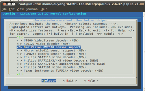

  Recently I am engaged in the work of add the ov7670 driver to L138 evm board .The figure below shows  a block diagram of the system. Motherboard is LOGIC L138EVM board,I design a daughter board connect to the pin of J29 . The daughter board connect a OV7670 camera as the Video Input.
The main file In dvsdk_ompla38-evm_04_03_00_06 Software Development Kit I modify is :
  First:  add the ov7670 driver when make menuconfig.

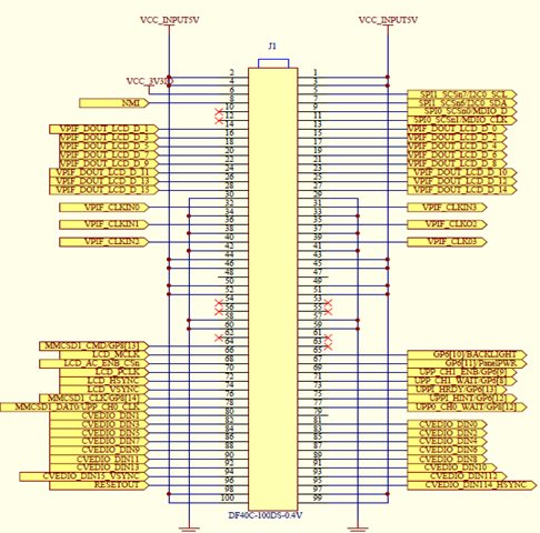

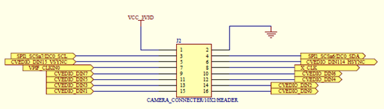

       At last a brief introduce daughter boards as follows,could you confirm some problems in the daughter baoard design.
    My daughterboard schematic as follows:
      1)、the first figure is LOGIC L138EVM J29 Port that connect to daughter board.
    I mainly use CVIDEO_DIN[0:7] I2C_SDL,I2C_SCL,VPIF_CLKIN0,CVIDEO_DIN14_HSYNC and CVIDEO_DIN15_VSYNC to connect to ov7670 camera.
    2)、the second figure is the DIP_16 pin to connect a ov7670 camera module.
    Attached is the LOGIC L138 EVM board shcematic and daughter board shcematic.
    1488.L138daughter boards.pdf1732.1016572B_AM1808_OMAP-L138_Baseboard_Schematic.pdf
       Thanks every much.
