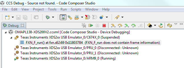

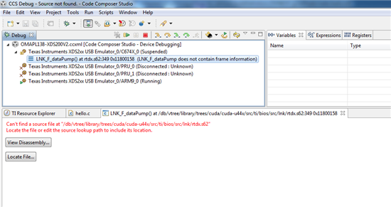

BTW, there is always one information when stop DSP core.
Is it normal?
FXNF_run() at fxn.s62:69 0x118037B4 (FXN_F_run does not contain frame information)
The uart console will be halted when DSP/BIOS task shift.

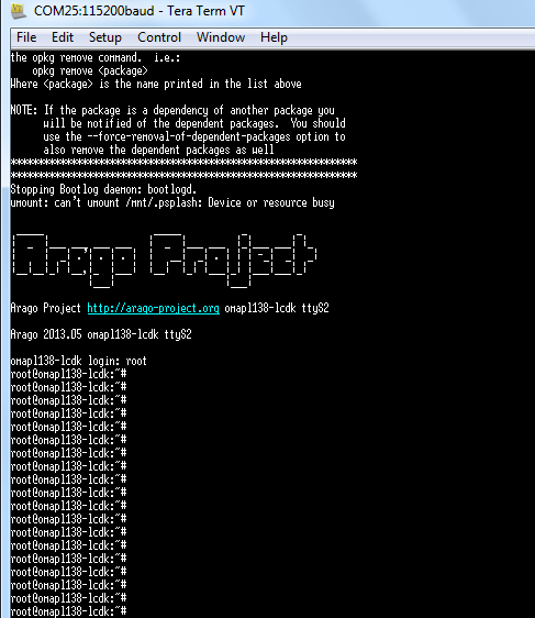

My customer found that the console will be halted in below scenario.
1. Run Linux in ARM9;
2. Connect ARM9-core;
3. Connect C674x-core;

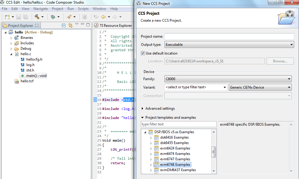

4. Load hello.out into DSP and run;
It used DSP/BIOS hello example for test.
When run DSP core, the uart console is active;
But it will be halted when stop DSP core running.
The uart console:

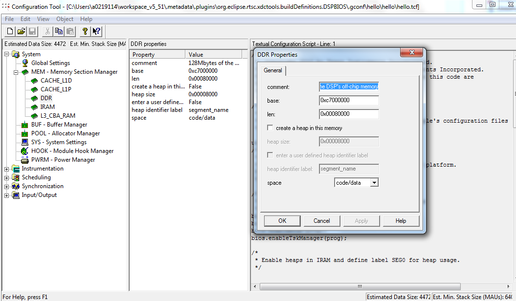

For hello project, I modified memory base address and length for DDR in order to avoid DDR memory confliction with ARM9 Linux.
Hi Gary,
Try to change the memory to internal DSP RAM L1/L2/L3 (shared RAM -> Which is not used by Linux) to run the hello program in DSP core.
IRAM is OK.
But why it doesn't work, even using DDR memory which is not used by Linux?

I'm confused that I have set linux memory map as
mem=32M@0xc0000000 mem=64M@0xc4000000.
So it should be OK if I set DDR base 0xc3000000 and 0x80000 length for DSP.
But it still fails.

Hi Gary,
I think, you can use "0xc3000000" as base address for DSP program.
The below table gives the configurations about linux memory map.
syslink_2_21_03_11/examples/ex01_helloworld/shared/config.bld
/* Memory Map for ti.platforms.evmOMAPL138
* C000_0000 - C7FF_FFFF 800_0000 ( 128 MB) External Memory
* C000_0000 - C1FF_FFFF 200_0000 ( 32 MB) Linux
* C200_0000 - C200_FFFF 1_0000 ( 64 KB) SR_0 (ipc)
* C201_0000 - C2FF_FFFF FF_0000 ( ~15 MB) --------
* C300_0000 - C37F_FFFF 80_0000 ( 8 MB) DSP_PROG (code, data)
* C380_0000 - C3FF_FFFF 80_0000 ( 8 MB) --------
* C400_0000 - C7FF_FFFF 400_0000 ( 64 MB) Linux
Please try it let me know the status.
