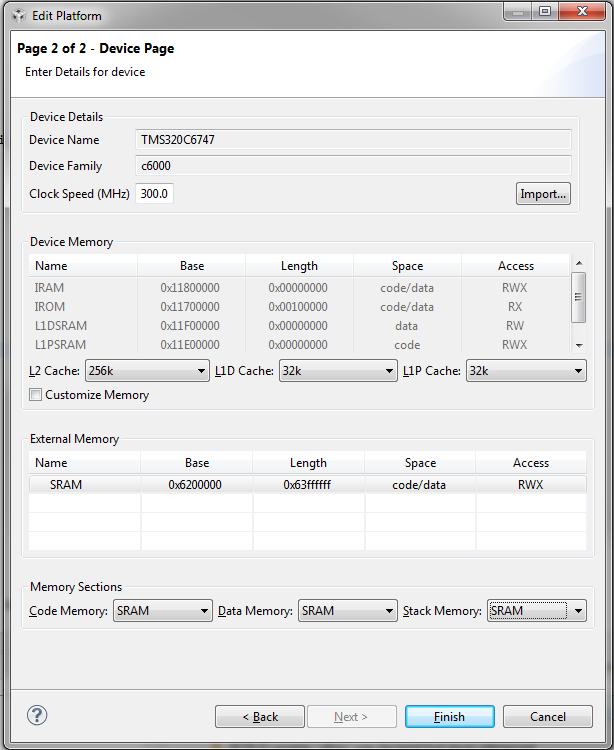

I have a project I am currently working with that I would like to boot the DSP on my OMAP L137 processor to SRAM instead of SDRAM.  In the data sheet I have found the memory mapping for the asynchronous memory for the DSP, along with how to define the memory locations for program and data memory in CCS through the platform definition.  The only piece of the puzzle I have is how to get the boot-loader/boot process that is defined by the AIS GEN tool to allow the boot sequence to write to the SRAM on the EMIFA  bus.  This doesn't seem to be an option in the AIS GEN tool so I was wondering if it is possible or if the only way to boot and run large programs for the OMAP L137 is to boot into SDRAM?
One option I thought of was to write my own bootloader, which is small enough to fit into the processors internal memory.  I then allow this to configure the SRAM interface to that section of memory, and even copy the program into memory if necessary.  Then jump to the program in the SRAM once the program is running.  This seems complicated, and not sure if it would work given the way everything is defined.  Any information or experience along these lines would be helpful.
Some information about my setup:
I am using an SPI EEProm for my non-volatile program memory and my boot mode is set to SPI.
I am using CCS Version:   Version: 6.0.1.00040

  • Hi Chris,
    Please refer to the following TI wiki for bootloader (DSP) to run the ARM app as well DSP app on OMAPL137.
    processors.wiki.ti.com/.../Boot_Images_for_OMAP-L137
    You have to modify the *.cmd file to boot from SRAM.
    Before that, have you tried to run the app on CCS IDE through Emulator ?
    PS: You have to initialize the SRAM in gel file and then you able to run DSP/ARM app on OMAPL137 on CCS.
    Also, you can access the SRAM through CCS's memory browser after you initialized the SRAM in gel file.
    I hope this helps.
    Please revert to me for further directions.
    FYI: James reached out me for this issues.
  • Initially I want to say thank you for your help as I start to understand the entire memory system of the OMAP L137 better.  We have an OMAP L137 EVM that is put together by Spectrum digital.  We have been able to do a lot with this when it comes to flashing the chip using the standard SDRAM configuration.  I have been able to us AIS GEN, spi_flash_writer_dsp, and such to actually flash the EEProm on the board and get the tool to boot to SDRAM.   Right now I don't have a setup yet that allows me to actually utilize the SRAM but we are working on a prototype setup now that will hopefully soon be able to allow me to work with it on our dev board shortly through the EMIFA.  With all that said, I am trying to do my upfront investigation to make sure I know how all the pieces fall together before we get too far down the road.
    It is my understanding that the *.cmd file is generated by the AISGen tool when combining the boot configuration, and the .out file we want to flash to the tool.  How do I modify this?  I haven't been able to find any documentation specifying where I would find a custom file, what the format is, or how to modify it to configure the registers that would be necessary for the SRAM.
    Another thing that I am confused about is the address bus for the EMIFA.  On page 86 (picture below) of the OMAP-L137 data sheet there is an example configuration for the EMIFA with SDRAM, NOR, and NAND flash.  In order to increase the address bus size for the NOR flash it looks like they have hooked up 6 GPIO pins.  I haven’t been able to find anywhere that discusses how to configure this so that the controller knows about these pins.  Is that possible?  Or do you have to manually configure these, and manage the write cycles to the memory?  This also confuses me because the OMAP L137 Memory map for the asynchronous memorys specifies an available memory space of 32Mbit.  To me based on this memory map you would need at least 21 bit bus width in order to fill it so I was wondering if there was something I was missing about how to configure this for larger memory spaces.
    Finally, for the OMAP-L137 dev kit I have been able to develop a secondary boot loader that allows me to flash the OMAP l137 from a terminal window after initial programming.  With that said I have a couple of questions about how the memory spaces will all work out for this.  In CCS in the Tool- RTCS Tools -> View/Edit Platform I pull up the memory mapping.
    I want the boot loader to run entirely out of internal memory so I have setup everything to run out of the L2 Cache memory space and as a result I have it setup as follows below.  In this config I believe I have left L1D cache open and L1P cache open for the processor to actually use as cache, is that a correct assumption?
    When I compile and configure my run-time program I want it to run entirely out of the SRAM and leave as much of the CACHE available for CACHING in order to help mitigate some of speed degradation we will get due to using SRAM.  For this I plan to configure the memory space in the project as such:
    Is there anything I need to do when my secondary boot loader finishes running out of the L2 Cache and jumps to the main program in SRAM to designate that I want the SRAM to now be used as actual RAM instead of just a memory space for the bootloader program?

  • Hi Chris,
    Thanks for your detailed explanations.
    No, *.cmd file is required to generate *.out with each and every section declared.
    AISgen tool is to convert to *.out to *.ais file for booting image alone. If we want to boot the board with bootloader and application then we have to convert bootloader's *.out to *.ais file and application needs to be converted from *.out to *.bin.
    Please refer to the following TI wikis.
    processors.wiki.ti.com/.../Linker_Command_File_Primer
    processors.wiki.ti.com/.../Linker_CMD_Files_for_CCS
    As far I know, we can use GPIO pins for NOR flash higher address lines, we have to configure it through software and NOR is XIP so, we may need to change some software part for that to access the GPIOs as address lines.
    I will get back to you on this to provide more input.
    Yes, you are assumption was correct.
    We need to get the "entry point" of main program from that project's *.map file and need use it in bootloader code to jump.
