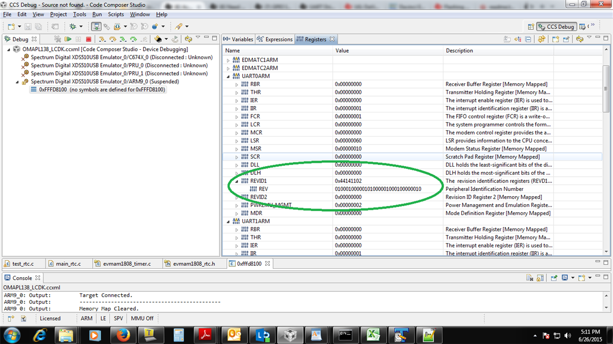

    For example the REVID registers for some peripherals (e.g. UART0 and UART1) shows zero whereas others (e.g. UART2) show what looks like a sensible REVID value.
    I simply connected LCDK and run script file and was able to see REVID for all three UART's. i.e UART0, UART1 and UART2.
    Below are the screenshots of UART registers.
    Please validate.
