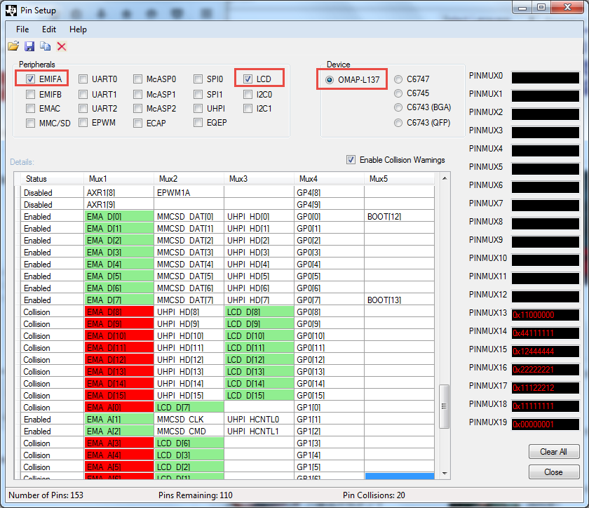

HI
We want use NAND Flash and LCD together on User Interface Board for DA830(from spectrumdigital)
For what on below site, when we want config NAND flash we must unconfig LCD?
  • Hi Stephan James,
    I don't see any relationship between LCD and NAND. It looks like when giving example(above image), their kernel configs seems to not have LCD config, but otherwise there is no need to disable the LCD for enabling NAND(which they would have mentioned in WiKi if so and also interfacing wise both seem to be separate with LCD controller and EMIF controller).
  • Dears
    Based on below picture from OMAP-L1x7_C6747-5-3_pinsetup software. it seems there are some pin collision about config LCD and NAND Flash together. How we can use from LCD and flash together when we have collisions on pins?
    Thank you again,I am sorry to reply late
    Stephan Jame
