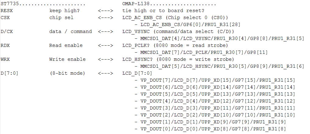

  • Thanks for the clarification. I am trying to quickly prototype a working 8080 interface for a TFT LCD display. I notice that the LCD header on the LCDKOMAPL138 kit is routed through a  video DAC or Dual Voltage Buffer. I am just looking for some clarification if this might work, before running too far down the wrong path. Are the LCDK header usable at all in the 8080 mode - J14 and J15? I am not seeing how I can use the GPIOs as bidirectional to send 8 bit LCD data -(D0-D7). Would appreciate your input.
  • Hmmm. All that video logic might be in the way. U14 has its direction tied from B to A, so it will be difficult to read back from the ST7735 registers.
    Just looking at the data signals for now... You might have to blue-wire from U14 and lift the OE pins and pull-ups. Otherwise, you can get output-only data signals on P1 and P2.
    Or would you rather bit-bang the LCD data out from the GPIOs through J14?
    Is this your desired mapping to between the ST7735 and the OMAP-L138?
    Mark
    [EDIT - fixed spacing with image...]
  • Mark,
    On second thought, using the LCD Bank with the above pin out may be the desired operation.
    Should I just remove U21 and jumper the pins?
    Would P1 and P2 be able to function bidirectionally or just as outputs?
    I can still use one of the I2C buses from J14/15.
    How do I configure the LCD_D[7:0] pins? As GPIOs ?
    Unrelated but is it possible at all to have bidirectional GPIOs? I understand that they might have weak pull ups. How do I configure a pin to be bidirectional?

    If you can get by with the data signals as output only, then all the 8080 LCD signals are present at P1/P2 (1.8V IO, which works for ST7735)
    If you must read back from the LCD registers via the data signals, then blue-wiring is required, and they will be at 3.3V IO (at the high end for ST7735)
    LCD_AC_ENB_CS (Chip select 0 (CS0)) @ U12 pin 6 (3.3V IO) (level shifts from B to A)
    LCD_VSYNC (command/data select (C/D)) @ U24 or U15 pin 6 (3.3V IO) (level shifts from B to A)
    LCD_PCLK? (8080 mode = read strobe) @ U12 pin 7 (3.3V IO) (level shifts from B to A)
    LCD_HSYNC? (8080 mode = write strobe) @ U24 or U15 pin 7 (3.3V IO) (level shifts from B to A)
    LCD_D[7:0] or LCD_D[15:0] @ U14 Lift OE pins 25, 48 solder to B side (3.3V IO) - 8-bit or 16-bit mode
    No, U21 converts analog video input to VPIF video input pins
    Before the LCD signals arrive at P1/P2, they go through 3.3V to 1.8V level shifters with direction fixed from B to A. So the LCD Data signals are output only at P1/P2.
    You can use I2C at 1.8V IO at P1 and P2. Or else wire to the 3.3V side at J15.
    You will need to pin mux the LCD signals out of the device to the device pins.
    Refer to 11.5.11 Pin Multiplexing Control Registers (PINMUX0-PINMUX19) in the OMAP-L138 Technical Reference Manual (www.ti.com/.../spruh77c.pdf)
    For example PINMUX16_31_28 should get set to 0x2, to route LCD_D[2] to the pin.
    Then within the LCD peripheral, you will have to configure the LCD to LIDD mode in LCD_CTRL register, and the LIDD mode to Async MPU80 (8080 mode, no clock).
    I would start with a software example.
    Not really. The GPIOs have a direction register, output or input.
    The GPIOs have configurable internal pulls, but their levels are tied together as a group.
    For example CP[28], CP[29], and CP[31] control all pulls on the LCD pins.
    Refer to section Table 3-24. Liquid Crystal Display Controller (LCD) Terminal Functions in the datasheet for the LCD pin to CP mapping
    Also refer to TRM sections 11.5.23 Pullup/Pulldown Enable Register (PUPD_ENA) and 11.5.24 Pullup/Pulldown Select Register (PUPD_SEL)
    Hope this helps,
    Mark
