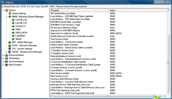

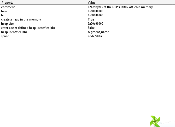

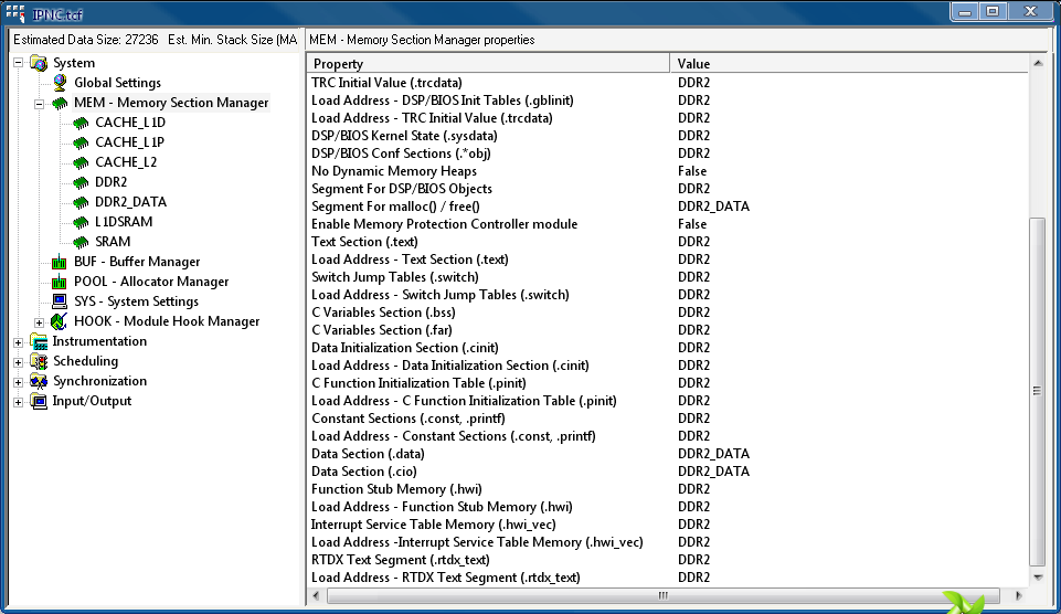

I want to create a contiguous buffer  to store 20 frames of image data in DM6437.  My choice is to use "memory_contigalloc " , but it fails.  In fact,  the heap size of DDR2 is set as 0x02000000 by the graohic DSP/BIOS Configuration Tool ,which is enough for storing data. DDR2 properties and MEM properties is as bellows:
1. DDR2 properties
2. MEM properties
question 1: How did that failure happen? What should we pay attention to before using that function?
question2:  Both memory_contigalloc, MEM_alloc and BUF_alloc can be used to creat large buffers. What is the differrence for different applications?
    Thanks for your post.
    It all depends on how the linker splits the output sections among multiple memory ranges to achieve an efficient allocation. Please refer sections 8.5.4.6 & 8.5.4.7 in the c6000 assembly language tools user guide as below:
    http://www.ti.com/lit/ug/spru186x/spru186x.pdf
    Thanks & regards,
    Sivaraj K
