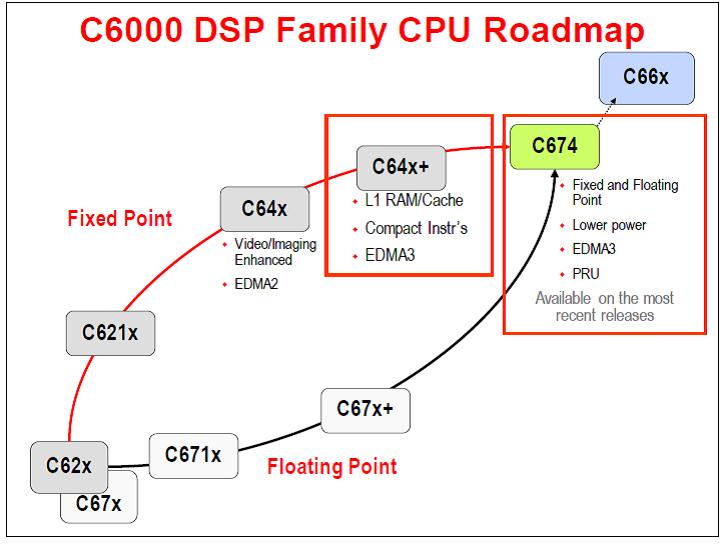

Can someone tell me what does TMS320C64x+ refer to ,
what is the difference between TMS320C64x+ and TMS320C64x,
I see the imglib for both version , is there any imglib for C674x?

Thanks for your post.
We do have image libraries for c64x, c64x+ & c66x but i don't think for c674x.
c64x+ core is the next higher revision chip of c64x core.
However, the IMGLIB 3.1.1.0 is fully optimized for C64x+ and is compatible to run on C674x. You can find the release of IMGLIB 3.0.1 as

As i am not familiar with c64x+ core which you say is the next higher revision chip of c64x core.
Could you introduce for me ,
I know dm642 belongs to c64x core,
which chip belongs c64x+ core, 6467 or something link that?
And what C674x belongs to
currently we use c64x imglib sprc094 on dm8168 C674x float dsp,
Is this appropriate?
