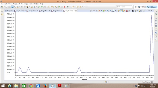

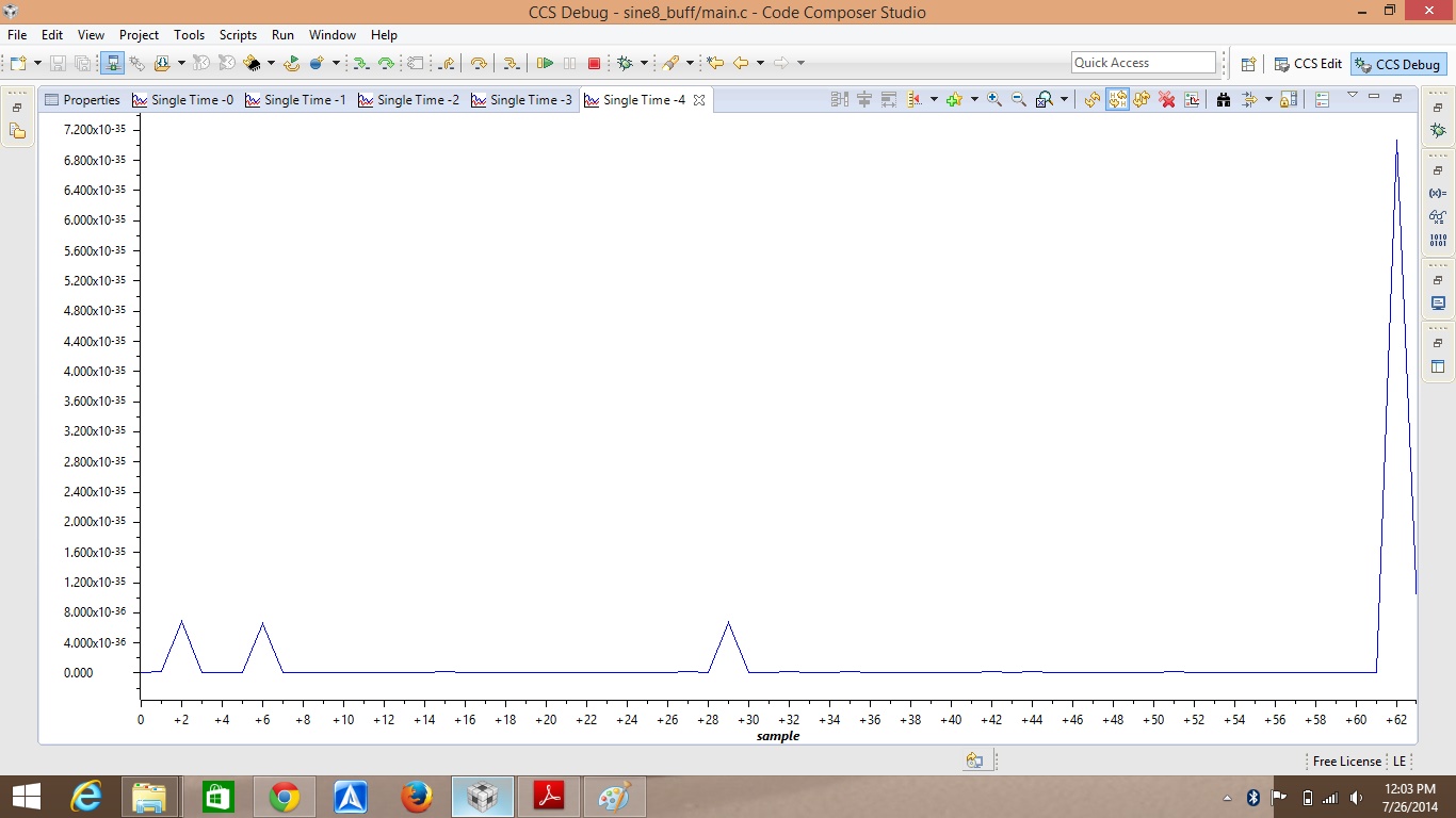

graph in ccsv6
Am using dsp6713 for my project. I started running a small program from Rulph Chassaing book but unable to get the required wvaeform. the program has no errors...can anyone suggest me whats wrong with it?
Am attaching the ccs proj folder3225.sine8_buff.rar
i got the waveform as shown below:
  • Hi Jythoi,
    Did you changed the source code which you got from text book ?
    Have you got any "warnings" while building the project ?
    I made some changes but again i used the same program fro the text book. Following is the code what am using.

    Have you configured the CCS graph (single time) as per your sine wave configuration ?
    Acquisition Buffer Size  : 256
    Sampling Rate Hz  : 8000
    Dsp Data Type  : 16 bit signed integer
    Try to use the below table as sine wave values and LOOPLENGTH value.

  • Yes i have use but no reslts moreover i got an error:
    I have build and debugged the program. I right clicked on the last line and selected run  to line. It is showing Run to Line failed.

    I tried the program given but still i dint get the rsults. The steps what i followed:
    save prgrm-> add path of the header files and lib files-> build-> debug->graph
  • I got the following warnings:

    The problem is when i plot the "buffer" i can see some random garph. The thing is i dint give any input to it. What should  be done please help me out.
