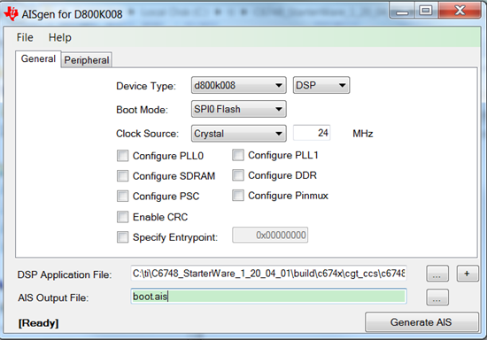

  • Hi Titusrathinaraj,
    I'm following the steps in OMAPL138 StarterWare Booting And Flashing.
    1. using AIS gen to create the bootloader AIS file
    boot mode - set to SPI0 flash
    application file - set to C:\ti\C6748_StarterWare_1_20_04_01\binary\c674x\cgt_ccs\c6748\lcdkC6748\bootloader\Debug\boot.out
    AIS file out - set to boot.ais
    2. import the timer project given at ..C:\ti\C6748_StarterWare_1_20_04_01\build\c674x\cgt_ccs\c6748\lcdkC6748\timer" into CCS, build and generate the timerCounter.out.
    3. Using out2rprc to Create the Application Binary out2rprc.exe timerCounter.out timerCounter.bin
    4. On C6748 LCDK board,set the boot switches for UART mode(1:4 = 0101 on C6748 LCDK). Open teraterm and can  get the "BOOTME" message.
    5. By sfh utility, flash the two images, boot.ais and timerCounter.bin using the below command.
    sfh_OMAP-L138.exe -flash boot.ais tmerCount.bin -targetType C6748_LCDK -p COM3
    In this step, it stuck as doing Programing UBL into flash...
    I also tried with emdaTest project, got the same problem. Do you know the reason?

  • Hi Jing Song,
    The C6748 LCDK board has only NAND flash in it. It doesnot have SPI. In SFH utility, if the flash type is not mentioned, by default it will consider SPI flash.
    you have to mention the "-flashtype NAND" to make it work.
    Use the command like below and let me know the result.
    >sfh_OMAP-L138.exe -flash boot.ais tmerCount.bin -targetType C6748_LCDK -flashType NAND -p COM3
     Other things from your screenshots:
    1. And also, in the "AIS gen tool" select the BOOT mode field as "NAND flash"
    2. check whether the name of the binary "tmerCount.bin" is correct. Because, in your fifth step you mentioned the name as "timerCounter.bin". (Spell check of the file name )

  • Thanks Shankari,
    The problem was solved. I also refer to the ais configuration in another post -- http://e2e.ti.com/support/dsp/omap_applications_processors/f/42/t/235049.aspx?pi301055=1
    My purpose is to develop a my own boot loader. So, I guess I can modify the bootloader code under \C6748_StarterWare_1_20_04_01\bootloader and debug it with emulator, right?
    Jane
