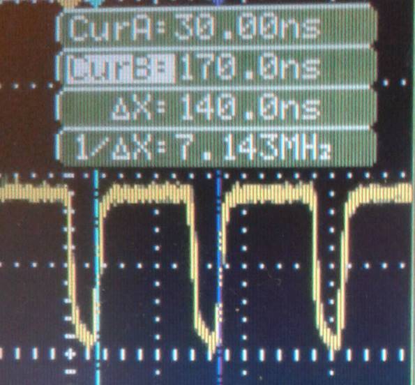

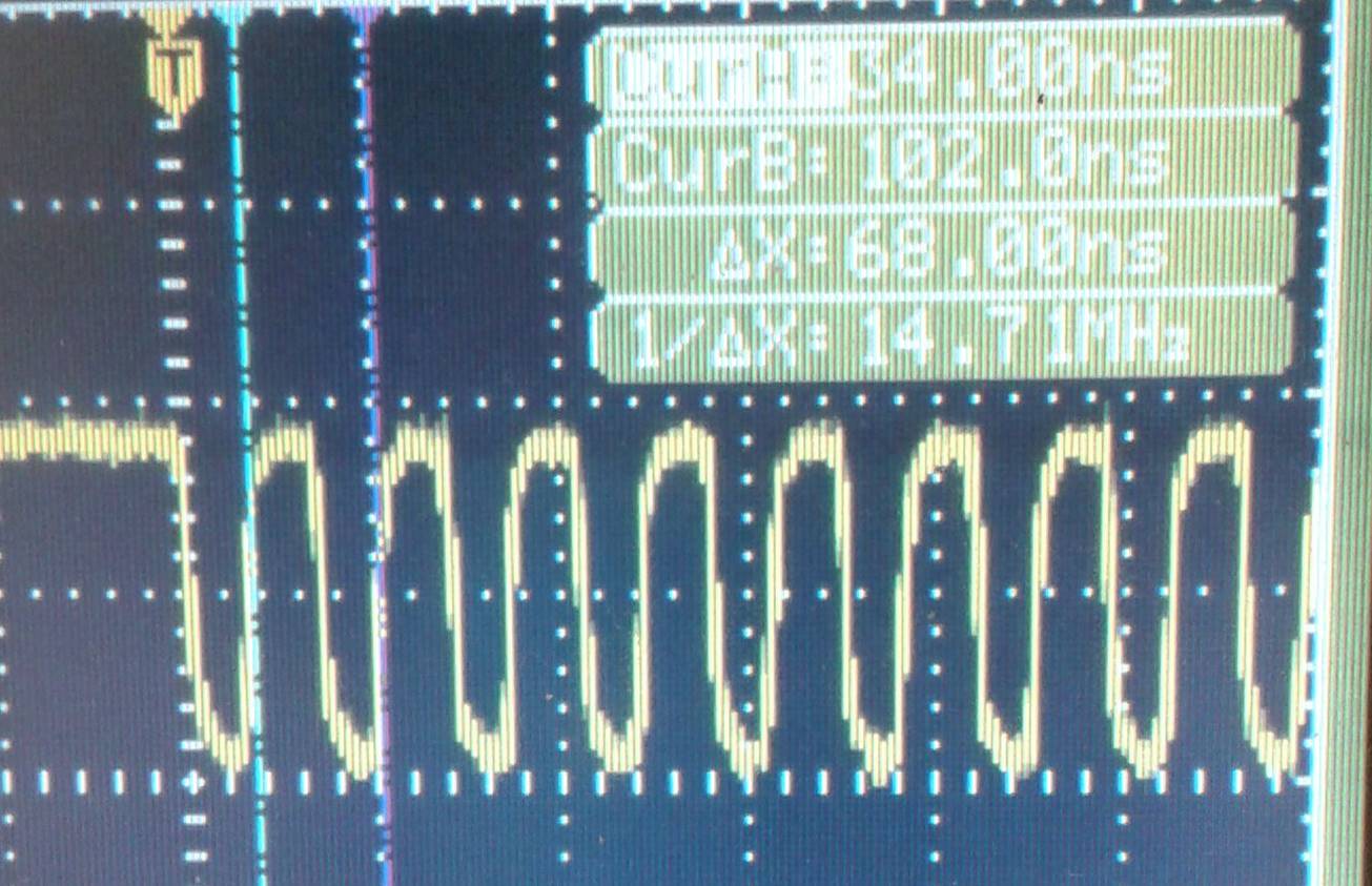

I am serving an asynchronous FPGA with EDMA through EMIFA.
The EMIF (100MHz clock) is configured with hold  = 1, strobe = 3 and setup = 1, both for writing and reading.
The EDMA configuration is the same for the writing (from internal memory to FPGA) and the reading (from FPGA to internal memory) operation as well.
I noticed (by checking the WE and OE signals with the oscilloscope) that the time required for writing one 16 bit data to the FPGA is about 70ns, while for reading 16 bit data it takes 140ns!!!!
Any idea about the reason of this difference ?

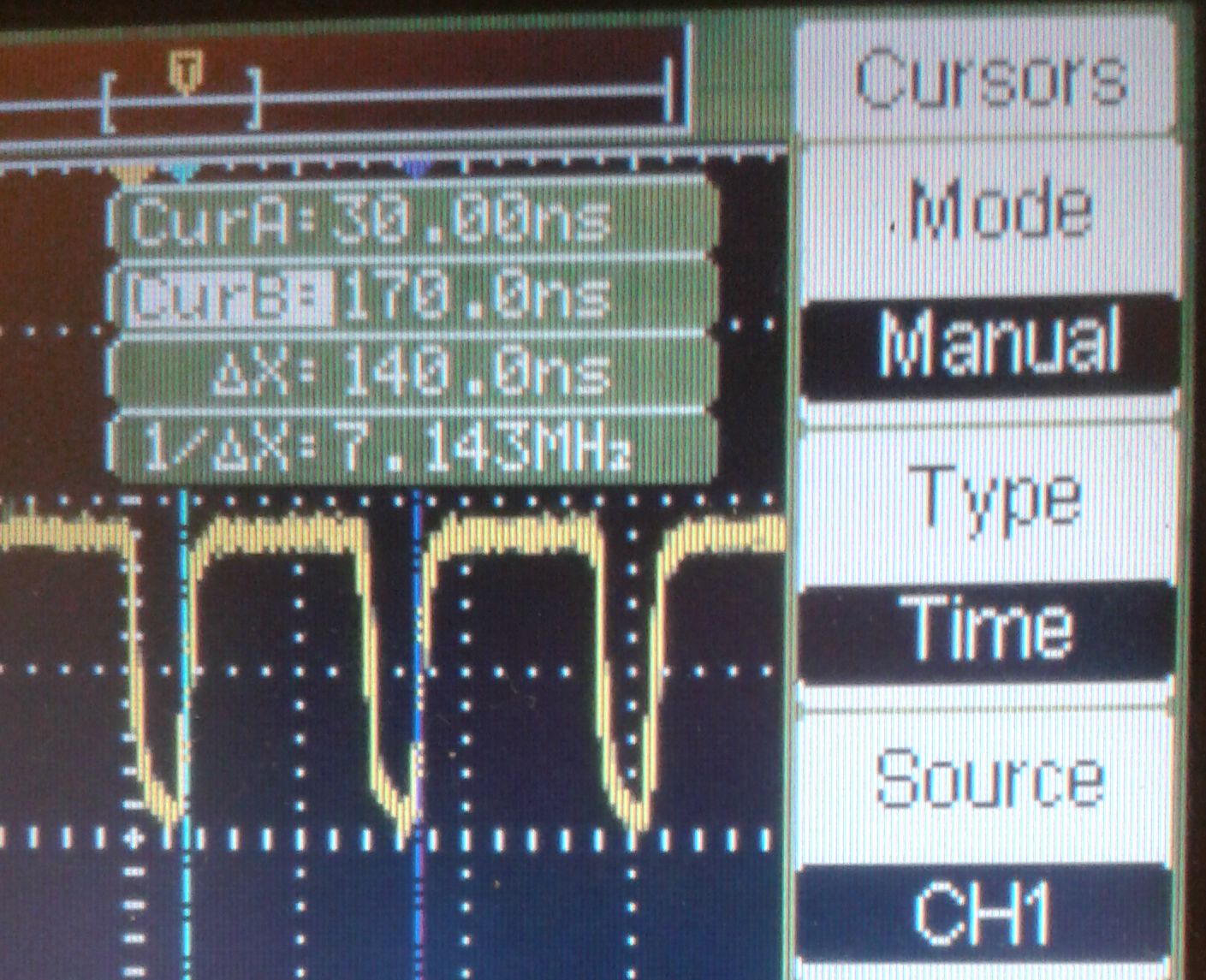

  • Hi Randy,
    I checked the WE and OE signals of EMIFA, I attach a picture of the oscilloscope (WE in the first picture, OE in the second). The time measurement is taken between two successive falling edges of the WE/OE signals.
    The values 1/3/1 are the resulting N values, i.e. I configured the register with values 0/2/0.

  • Hi Randy,
    when using the DSP the WE pulses were a bit closer: 50ns instead of the 70ns that I see using the DMA (by calculations, the duration should be 50ns, i.e. setup + strobe + hold).
    I changed the EDMA configuration to do sequential transfers, and both the reading and the writing become faster, but there is still something weird: with the sequential transfer I have 8 data transfer of the correct duration (50 ns), and then I see the signal high for a longer time (40 ns for the writing and 110 for the reading, instead of the 20ns that I would expect), and then again the timing is ok for 8 transfers etc....
    Probably the TC still does something that we don't know, can it be some latency time for the managment of arbitration between different transfers? I don't understand why this extra time occurs every 8 data (both in reading and writing), which is not a dimension of my transfers ...
