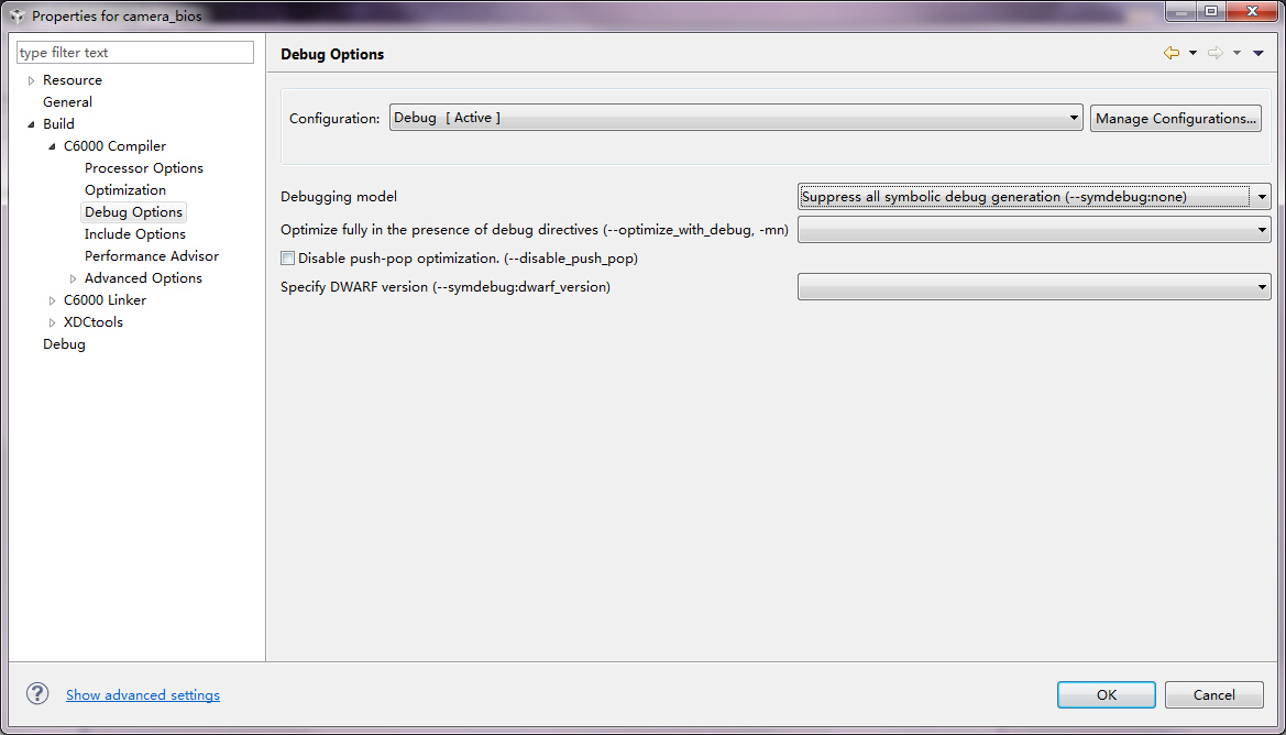

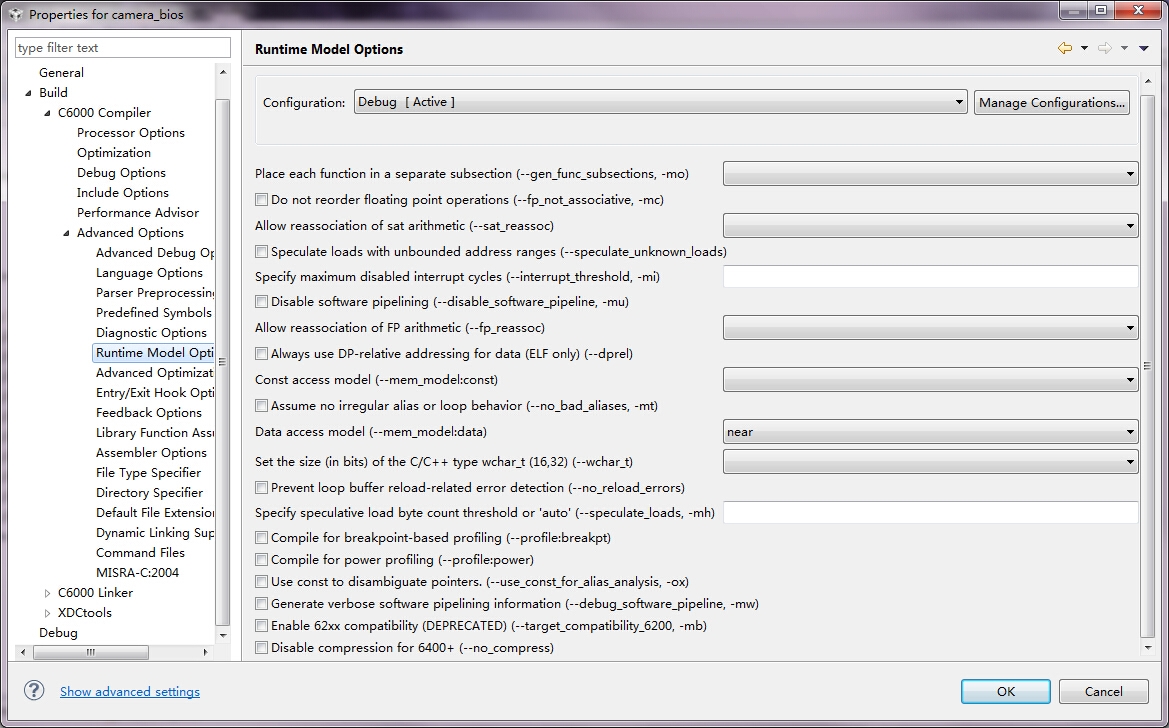

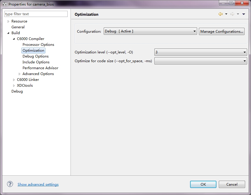

when i don't use any optimization, the lcd works well. When i use O-3 optimization, the screen will flicker . then i enable the cache of L1 and L2, it stops, but the image will be divided into a few parts and shows a falut position.
i use my own boad of TMS320C6748. off course i change the code of lcd raster setting
the lcd data points to ddr2 in a certain addr, i update the data every time.
here are the optimization setting.
