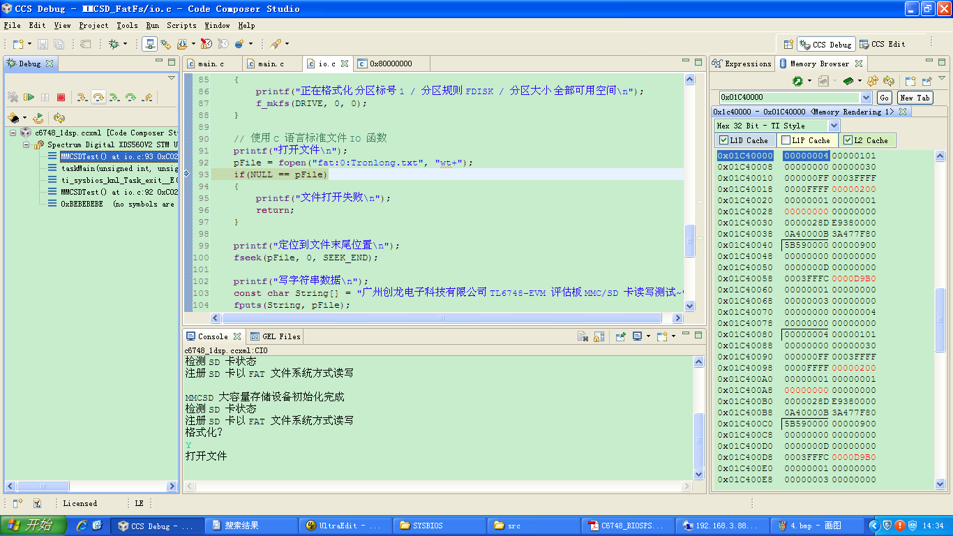

      Now we are debugging MMCSD FAT on C6748 of MMCSD1(we use the TF card) with JTAG,We encounter the following issues:
MMCSD1 checks card Successfully,but it will hung in "f_mkfs(DRIVE, 0, 0)"????,we changed TF card many times,the result are same.We do not know why???
We have some screenshots about MMCSD1 registers as follows:
1.when connect the JTAG
2.when running" mmcsdStorageInit()",it return success;
3.when ran "checkMediaCard(MMC_INST_ID)",it check TF card successfuuly!!
4. when Executed down,it will hung in "f_mkfs(DRIVE, 0, 0)",we donnot know why???
our gel and code are As shown in Annex.

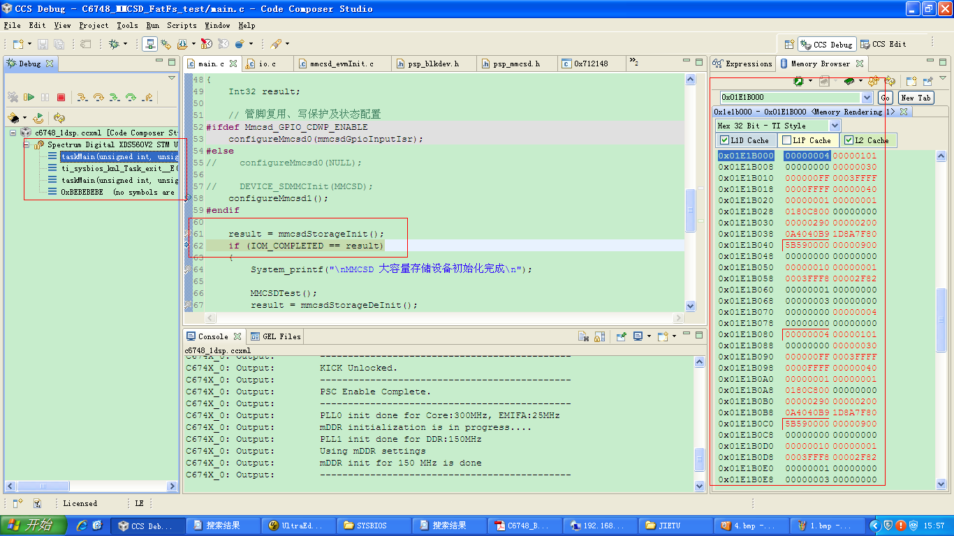

  • Hi Arvind Singh:
          Thanks for your reply,yes we have Screenshots for both EVM and custom board after running our own build codes,but different gel files(because the gel file depends on hw).
    EVM use SD card with 8Gb on MMCSD0, Custom board use TF card with 4Gb on MMCSD1
    the Screenshots are as follows:
    1. when the JTAG connect the board:
    EVM board:                                                                                                                                                                                                                         custom board:
    2. when ran the function "mmcsdStorageInit()" (as the Red Shadow),and both are successful!!

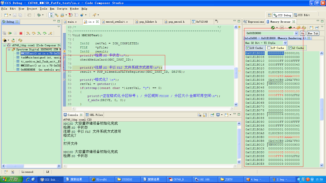

    3. when ran the function "checkMediaCard(MMC_INST_ID)" (as the Red Shadow),and both can check SD card successfully!!!!
    Void MMCSDTest()
        Int32   retVal = IOM_COMPLETED;
        FILE    *pFile;
        Int32   result;
        checkMediaCard(MMC_INST_ID);
        printf("MMCSD_SAMPLE:Card is inserted!\r\n");
        result = PSP_blkmediaFATfsRegister(MMC_INST_ID, DRIVE);
        if(IOM_COMPLETED == result )
         printf("MMCSD_SAMPLE:Media is registered with FATfs\r\n");
       else
         printf("MMCSD_SAMPLE:Media is registered with FATfs FAILED\r\n");
       printf("Format???\n");
       retVal = getchar();
      if(strcmp((const char *)&retVal, "y") == 0)
                printf("MMCSD_SAMPLE:Create Fat format on MMCSD\r\n");
                f_mkfs(DRIVE, 0, 0);

  • Hi Arvind Singh:
    EVM board:
     custom board:
    Void MMCSDTest()
        FILE    *pFile;
        Int32   result;

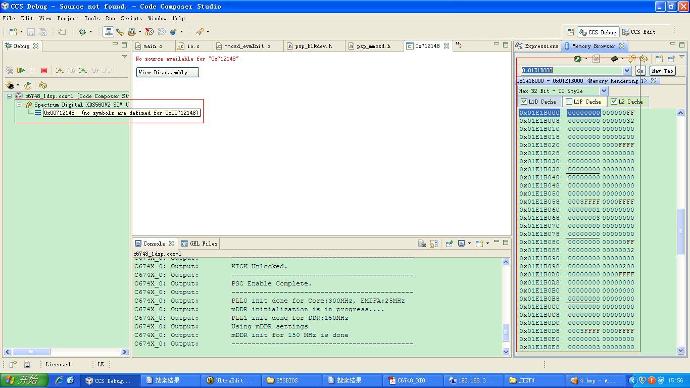

    Custom board:  (when pause ,the value of MMCSD1 registers)
    I really donnot know why????? we hope your help very much !!!
    Best   Wishes!!!

  • HI Arvind Singh:
         Thanks for your reply.
         1. The return value of "PSP_blkmediaFATfsRegister(MMC_INST_ID, DRIVE)"  is "IOM_COMPLETED"which means it goes well;
         2.but when it run " f_mkfs(DRIVE,0,0)",it will block in the function,and cannot get out of the function ,so we cannot get the return value;
       The only difference between Demo board and Our custom board is just custom board uses MMCSD1 FAT,but demo board uses MMCSD0 FAT.
    we really donnot kown what is wrong???
    or do  you have examples about MMCSD1 FAT for us?
    Thanks very much!! waiting for your reply!!
    Best wishes!!!

    MMC/SD data width or any hw changes ?
  • Hi Titusrathinaraj Stalin:
       No other hw changes have we been made other than MMC/SD controller.
      The MMC/SD data width ,clk(which is 37.5MHZ,and we have tried lower clk too) and so on are the same as EVM board.
     We have detected the MMC/SD clk with Oscilloscope which shows OK.
    and We have detected the MMC/SD data lines with Oscilloscope too,There are level changes which means there has data transmission.
    So,we really donnot know what is wrong??
    Waiting for your reply!
    Best wishes!
        No,we have not made  Any other hw changes  other than MMC/SD controller.
       The MMC/SD data width and the CLK and other configs are the same as the EVM board which can be show on the registers values.
       And we check the CLK、Command  and data lines with Oscilloscope,They all have  level changes which means working well.
      But we really donnot kown what is wrong?
      How can we do?
    Waiting for your reply!!
    Best wishes!!
      How can we do?
    Best wishes!
