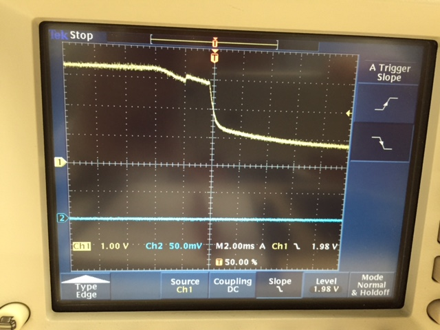

Drift Down of 3.3V Rail in Power-off Sequence
Other Parts Discussed in Thread: OMAPL138
Hi.
One of my customers found drift down of the 3.3V rail in the power-off sequence of C6746. It seems that it is pulled down by the 1.8V rail. Would you please tell me if this is a normal behavior as well as the drift up in the power-up sequence described in Advisory 2.3.18? Or does the power circuit need to be fixed?
