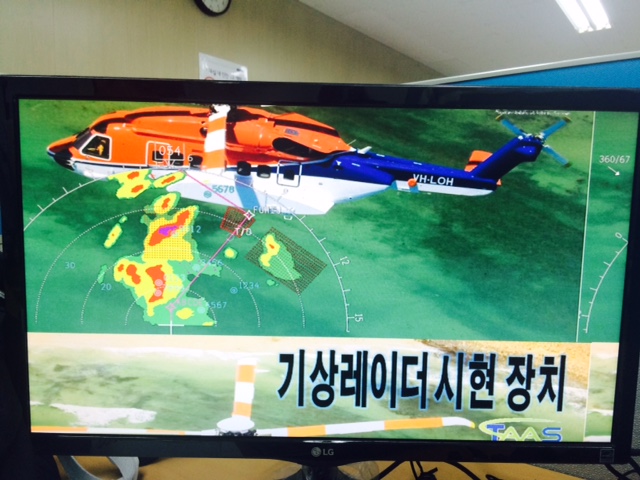

I have 2 questions about C6748.
1. Images are broken when I access the image array using pointers or memcpy
Above image is what i want to print out.
And to reduce the time, I used memcpy.
- This is my code : memcpy(VedioMem[0], TitleImage, 640 * 480 * 2);
- And TitleImage array :
unsigned short int TitleImage[] = {
      640, 480,
      0xCDB1, 0xD5D2, 0xD5F2, 0xD5F2,   0xD5B1, 0xD5D2, 0xD5F2, 0xD5D2,
      0xCDB1, 0xCDD2, 0xD5D2, 0xD5D2,   0xD5D2, 0xD5D2, 0xD5B2, 0xD5B2,
      ...(color info)...
But image is broken like this.
What is the problem?
2. When I use grlib, I can get unbroken image. But, "DpyPixelDraw" or "GrDrawPixel" is too late to express 640 * 480 pixels.(3xxx milliseconds)
If you have another way to print make shorter, please let me know. Thank you.

  • Thank you for your reply.
    Actually, I don't need any other special image processing library.
    My main purpose is just drawing an real-time radar image. So only pixel drawing is needed.
    When i draw an 640*480 image, i usually use double for loop and DpyPixelDraw API.
    However, it performs "for loop" almost 300,000 times and spends too much time to draw an 640*480 image array.
    Is there any other ways to reduce the time? (without changing devices)
  • Yejin Kim,
    Do you get the same distorted view each time you do the memcpy? Or will the offset to the start of the image be different each time?
    The memcpy() function is very simple and will do the same thing every time, so this information will help in figuring out what your code is doing incorrectly.
    In CCS, you can display an image from memory. Use this feature to display the TitleImage array to confirm that it is correct.
    Do you need to copy the two size values at the beginning of the TitleImage array? Those are not pixel values and most likely do not belong in the video memory region.
    Check your definition for VedioMem[0] to see if it is in the correct location.
    When you use the "double for loop and DpyPixelDraw", does the image appear correctly? I understand it is slow, but this is for debug purposes.
