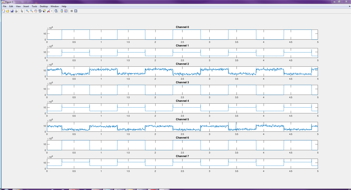

    thank you for your response. it was quite helpful. I managed to write and read registers of the device.
    However the samples themselves seem to be noisy in two channels (channel 2 and channel 5), when using the square wave test input signal.
    The gain is programmes for factor 6, sampling rate is 500 SPS in low power mode. Do you have a clue why this is?
    Cheers,
    Matthias
  • Hey Matthias,
    Strange... Not only are they noisy but they are phase reversed from the other signals. In addition, channels 1, 4, and 7 seem to have some "overshoot" near the edges. Would you be able to send me a text file with your entire data feed?
    Brian Pisani
  • Hello Brian,
    thank you for getting back to me. We just found two errors in our firmware and fixed them. The data now looks good, the ADS seems to be working correctly. Sorry for this mistake.
