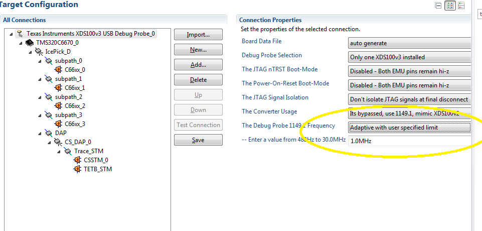

Is my chip has burned?
my ccs config like this  , i think it is 1mhz already。
1.is it possibale that just the jtag pins have problem on the dsp but the other functions is good? because before this problem i have download a program in it, it use spi module and gpio, and it is still work. just can't download program to the chip, every time this problem come out...
2. this is the log when i test connect to my target:
