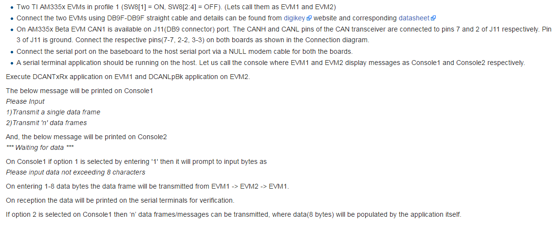

I have gone through the user guide of starterware where they have mentioned:-
I am a bit confused in these steps.
Can someone please clarify as how to connect and send frames ?
can i use teraterm as my serial communication console ?
