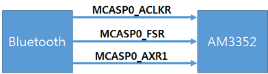

 I am trying to read I2S data using MCASP0 and write the data to MCASP1.
Now I modified mcasp example source code.("AM335X_StarterWare_02_00_01_01")
But this is not working. I think the reason is that RX interrupt does not trigger. So EDMA3CCComplIsr() function is never called.
I not sure that EDMA3 initialization is correct. Please check my source code.
thank you
