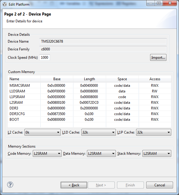

We have a platform defined for our custom 6678 board. Inside this platform we have been defining all the memory regions as custom. One of the memory region is called 'BOOT' and is located at 0x00800000 size 256 bytes, another memory region is called 'L2SRAM' and starts at 0x00800100.

I am adding a picture with the platform's memory configuration where we clearly see a BOOT area defined.

    I checked a bit 3) and it is interesting, the memory regions configured in my platform are simply not there. In my platform 'fmc667',L2SRAM starts at 0x00800100. I am again adding definition of my platform (memory.png).

  • Arnaud,
    the most frequent cause of the problem you are seeing is that the platform build fails, and then you are left with a version of the platform that you successfully built earlier. If that's the case, you would see a message saying that the platform build did not succeed. It's hard to tell why would the build fail, and if that was really a cause, without seeing a platform.
    You can try the following. Go to the directory D:\platforms\fmc667 and first open the file Platform.xdc to verify that the memory setup in that file corresponds to the memory from the screenshot you posted. Then, open the command line window in that directory and run:
    C:/ti/xdctools_3_23_04_60/xdc
    You should see if the build succeeds or if there are some errors. Please let me know how it goes, and you can also just zip up the whole fmc667 directory and post so I can debug further.
    Sorry for reacting so late. You were spot on, there was some updated in the platform I wasn't aware and the edit path wasn't D:\platforms as per your expectations
    Thanks for the help and pointers, this surely helped
