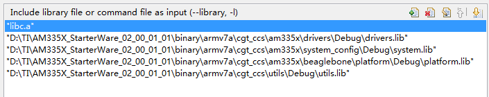

3. I have included some necessary header file.
4. I have added some libraries.
