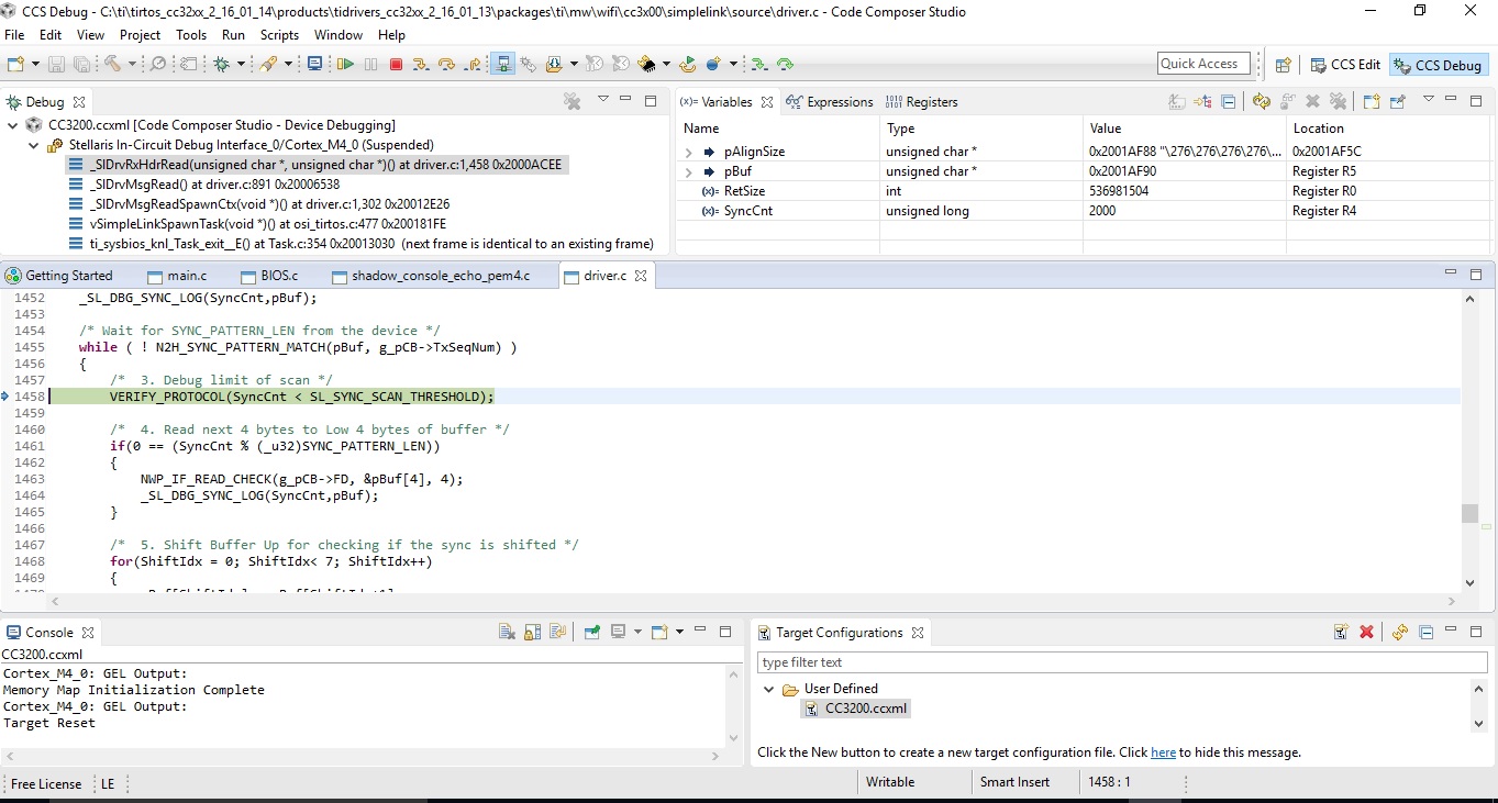

While running the subscribe_publish sample, the program gets stuck at VERIFY_PROTOCOL(SyncCnt < SL_SYNC_SCAN_THRESHOLD); in the driver.c file. It goes into endless loop on the same line with SyncCnt value shown as 2000. Please help me getting past through this.
  • Moving to TI-RTOS forum
    Gigi Joseph.
  • Pratyush,
    Can you please paste a screen shot of CCS when halt the application and see this issue?
    I'm interested in seeing the C call stack, as well as the Task view in ROV (Tools -> ROV, then navigate to the Task module).
    Steve
  •  Hey,
    Here is the screenshot for the C call stack, I'm trying something else with it now, will give you the ROV view ASAP.

  • Okay, here is what I have been able to do:-
    1. It used to randomly end up on the above given error for the certflasher.out file load run. But after power cycling, certflasher.out has worked perfectly both the times that I've tried until now.
    2. After the certificates get flashed. I press Alt+F8 to suspend the certflasher.out program. Then, without resetting the device, I load up the subscribe_publish_sample.out file. Before running it, I make the serial connection with the Tera Term software so that I can recieve the replies.
    3. After that, I run the loaded up sample and wait for a minute for any response to come up in Tera Term. Nothing comes up.
    4. So, I suspend the program by pressing Alt+F8 and end up with the following screenshot (if you need any other view in the ROV, let me know):-
    5. If I continue to locate the file, then it leads me to the VERIFY_PROTOCOL endless loop.
    How do I solve this from here? Let me know if you need any other information. BTW, I'm using the latest version of all the required tools and SDKs.

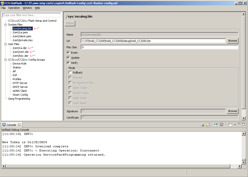

  • hi steven,
    I fixed this problem by flashing the certificates into the cc3200 first through uniflash and then loading the .out file of the example. Maybe there was some problem while loading both the .out files one after another.
    regards,
    sumit
  • Hi Sumit,
    Can you share the procedure to flash the certificate to cc3200 using uniflash.
    I tried to follow the procedure in www.youtube.com/watch
    but did not work.
    Steve,
    Yes, i have powered cycled the board zillion times without any luck.
  • Hey Humanesq,
    Make sure the certificates and keys that you are saving are correct and are converted to .der format using openssl or any other tool.

  • Hi Humanesq,
    Just make sure to convert the .pem certificate and key files into .der format. To do so either use openssl or use (http://www.entrust.net/knowledge-base/technote.cfm?tn=5531) to convert certificates and for keys use (https://www.trustico.co.in/ssltools/convert/pem-key-to-der/convert-pem-private-key-to-der.php) and flash it then using the procedure given in the video.
    Sumit
  • (1) Converted the .pem certificate and key files into .der format and flashed them using Uniflash.
    Below are the files i see on device
    [20:04:05] INFO: 4 5 5 yes 10 /tmp/phy.cal
    [20:04:05] INFO: 6 15 33 yes 66 /sys/servicepack.ucf
    [20:04:05] INFO: 7 81 1 no 1 /cert/ca.der
    [20:04:05] INFO: 8 82 1 no 1 /cert/cert.der
    [20:04:05] INFO: 9 83 1 no 1 /cert/key.der
    (2) Unplugged/Replugged Board, Opened CCS, Connected to Target and Downloaded "subscribe_publish_sample.out" application. Application worked!!
    BUT ONLY ONCE!
    If i Terminate session, Repower Board, Launch new session, Connect Target, Hit Core Reset couple time (as indicated in forum before), and Load the application program, i get stuck again in VERIFY_PROTOCOL().
    I have to redo the "Whole process" again (i.e. step (1) and (2)) to make it work one more time.

    We are suspecting that something flashed previously to your CC3200 (some other app) is starting up the network processor before your sub/pub application has a chance to load/run from CCS.
    Can you try flashing the app in the attached CCS project?  This app called "hold" is meant to hold the NWP from starting.  It will spin in main() and blink an LED, never calling SimpleLink start and so the NWP should never start with this app.
    The idea is that when you power on your 3200, the "hold" app (that's flashed) will run first, but it won't start the NWP.
    Then, you load your sub/pub example and run, and it will be the first app to actually start the NWP and the SPI communication between the M4 and the NWP should all be in sync.
    Steve
    6138.hold_CC3200.zip
  • Hi Steve,
    So here are my try details based on your recommendations
    1. Created a .bin file so i could flash it on device
    2. Flashed hold_CC3200.bin and AWS Certs. Here is the snapshot of my Configuration
    Below is the list of files AFTER flashing
    [11:07:34] INFO: 	N/A	0	5	N/A	5		FATFS
    [11:07:34] INFO: 	0	81	11	no	11		/sys/mcuimg.bin
    [11:07:34] INFO: 	4	5	5	yes	10		/tmp/phy.cal
    [11:07:34] INFO: 	6	15	33	yes		  /sys/servicepack.ucf
    [11:07:34] INFO: 	7	92	1	no	1		/cert/ca.der
    [11:07:34] INFO: 	8	93	1	no	1		/cert/cert.der
    [11:07:34] INFO: 	9	94	1	no	1		/cert/key.der
    3. Next,  Removed the SOP Jumper (on J15 pin) and hit RESET. The Red LED started Flashing just as you described in your post.
    4. Opened CCS and Launched Debug session and Loaded and Ran subscribe_publish_sample.out. The problem was not resolved !!
    Details -
    On first try the program did not run as expected (which without loading the hold_CC3200.bin, it usually works as mentioned in previous posts). On Repowering and running  subscribe_publish_sample.out for 2nd time, it does gets stuck in VERIFY_PROTOCOL call. So it is showing same symptoms as before. Also, i was not sure while running CCS, it the SOP Jumper should be put back on? So i tried it both ways (On and Off) with similar results.
    Please let me know if there is anything else i can try or if i am following instructions incorrectly.
    Thanks.
