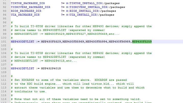

HI,
I've just installed CCS6.1.3 and trying to genrate driver files for MSP430F5259 (don't confuse with preinstalled MSP430F5529...)
I closely followed this article which is bit outdated but didn't go through...
1. First I've updated all installed tools from Help>CCS app center
2. I cd-ed to c:\TI\tirtos_msp43x_2_20_00_06>  and modified tirtos.mak as follows:
3. Then I've run c:\TI\tirtos_msp43x_2_20_00_06>..\xdctools_3_32_00_06_core\gmake.exe -f tirtos.mak drivers. (see attached output1.txt)

4.  Unfortunately I could not find any *MSP430F5529.lib file but could found the *ae430x files (in C:\TI\tirtos_msp43x_2_20_00_06\products\tidrivers_msp43x_2_20_00_08\packages\ti\drivers\lib)
Is this porting procedure is still relevant ?
Where did the *.lib file gone ?
