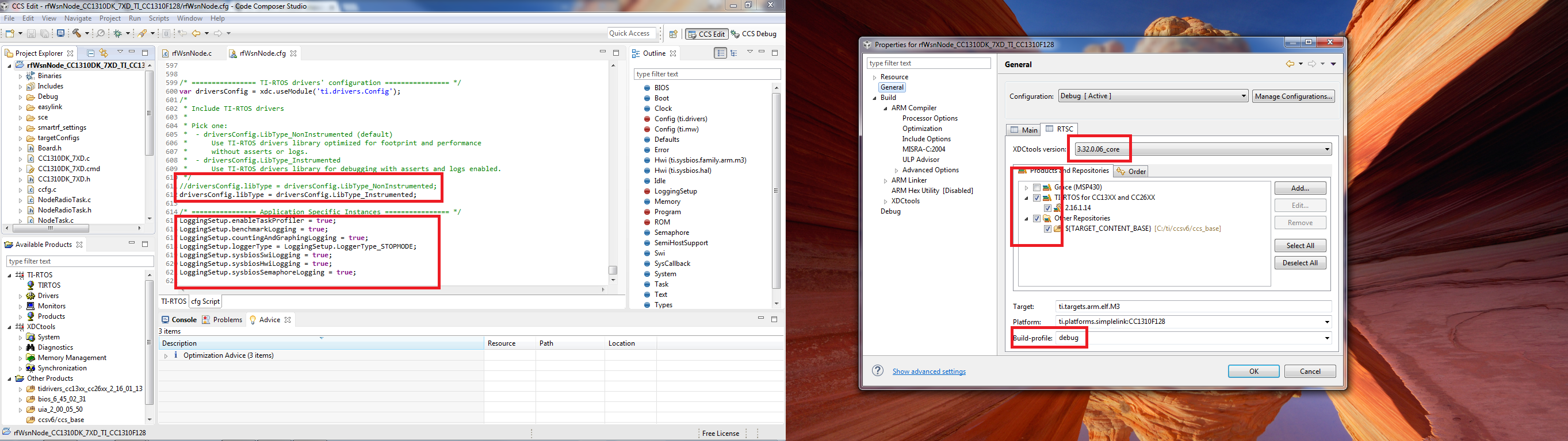

I've loaded up the example code for the CC1310DK to act as a "RF Wireless Sensor Network" Node and Concentrator.  The code works fine, as I can see packets coming in on the Concentrators LCD screen.

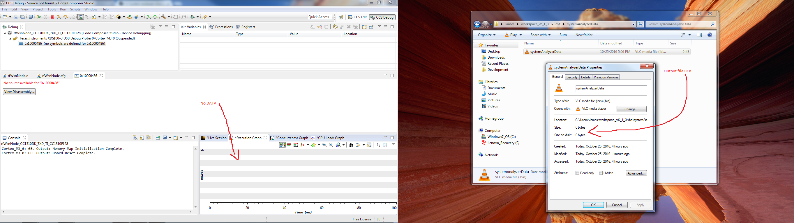

The problem looks like its with the RTOS setup, as I cannot get the System Analyzer to output any data.  I've gone through the setup process from the documentation and I must be doing something wrong.  My driversConfig.LibType_instrumented is setup, and I have enabled LoggingSetup in STOPMODE
But for some reason it is not working.  I found this and tried adding the code from the accepted answer, and it still didn't work, it just gave me a warning that says that the module is not longer required.
After finding this I went to  Help -> Update and updated everything, and also went to Help -> CCS App Center and update my TI-RTOS CC13XX/26XX
Still it doesn't log any data...
Does anyone have any idea why it is not logging any data?

    var LoggingSetup = xdc.useModule('ti.uia.sysbios.LoggingSetup');

    LoggingSetup.enableTaskProfiler = true;
    LoggingSetup.benchmarkLogging = true;
    LoggingSetup.countingAndGraphingLogging = true;
    LoggingSetup.loggerType = LoggingSetup.LoggerType_STOPMODE;
    LoggingSetup.sysbiosSwiLogging = true;
    LoggingSetup.sysbiosHwiLogging = true;
    LoggingSetup.sysbiosSemaphoreLogging = true;
    var task0Params = new Task.Params();
    task0Params.instance.name = "statusTaskHandle";
    Program.global.statusTaskHandle = Task.create("&statusTaskFunction", task0Params);
  • Hi James,
    It looks like the problem is that kernel logging is disabled. Since your application is being built against a ROM based kernel, logging has been disabled in the cfg script. In case you are not familiar with this, key modules of the TI-RTOS kernel have been burnt into ROM and in order to ensure good performance, they do not contain any logging code.
    A possible solution to get logging working is to put the kernel in FLASH. This can be done by commenting out the following code in your application's cfg file:
    /* ================ ROM configuration ================ */
     * To use BIOS in flash, comment out the code block below.
    var ROM = xdc.useModule('ti.sysbios.rom.ROM');
    if (Program.cpu.deviceName.match(/CC26/)) {
        ROM.romName = ROM.CC2650;
    else if (Program.cpu.deviceName.match(/CC13/)) {
        ROM.romName = ROM.CC1350;
    Please note that placing the kernel in FLASH will increase memory usage.
    Once the kernel is in FLASH, you can search for "BIOS.logsEnabled" and set it to true:
    BIOS.logsEnabled = true;
    Ashish
  • Thankyou sir, that did the trick.
