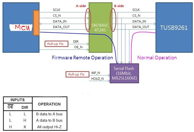

Can you advise if the following structure works for programming TUSB9261 flash by uC? Idea is to program the flash by uC while holding the TUSB9261 in reset state.
