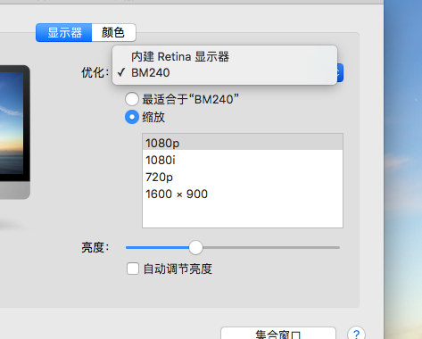

HI,
Different graphics card output dp source signal , through DP130 or DP141 to Xilinx 7Z045 gtx .
DP130:
(mac mini)Intel graphic card hd4000 :link rate 2.7/1.62Gbps link training sucess .
(mac pro)Nvidia GeForce GT750M 2048M :link rate 2.7/1.62Gbps link training sucess .
(iMac ) AMD Radeon R9 M395X : link rate 5.4/2.7/1.62Gbps link training failure .
DP141:
(mac pro)Nvidia GeForce GT750M 2048M :link rate 2.7/1.62Gbps link training failure , MAC PRO is crashed when the DP wire is insert
DP130 performance than DP141 ok?
what should be done to allow Z7045‘s GTX to receive these DisplayPort source signals?
thanks !!!

  • hi
    I set the voltage swing of the z7045 gtx to the maximum value(1000mv) . At a rate of 1.62gbps, the macbook was able to link successfully.
    But when I set the rate of 2.7/5.4gbps, minidp once access, macbook immediately died, must be restarted .
    why?
    Dp141 should be how to special configuration?
    Imac can read edid at different rates, but fails in the clock recovery phase。
    TUSB546-DCI similar to dp159? Whether it also contains retimer? Because gtx can not solve the dp ssc signal , so need dp159 to retire, convert the  ssc signal into a common signal.
    thanks!
