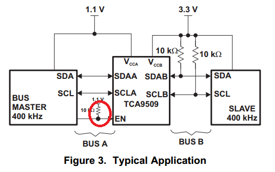

EN pin is pulled up to 1.1V via a 10kΩ resistor in the datasheet.
http://www.ti.com/lit/ds/symlink/tca9509.pdf
Can I connect directly to VCCA or VCCB when EN is not controlled by MASTER?

Seishin,
If Enable is not controlled by the Master, please connect it to VCCA through a 10kOhm pull-up resistor.
