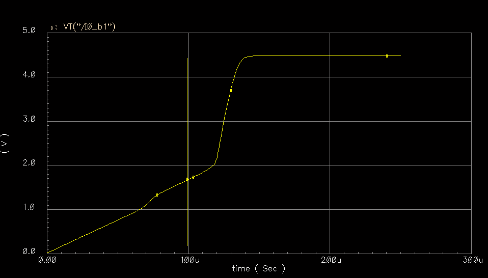

We will question the provisions of Δt / Δv of TXB0108/TXS0108.
Time of rise and fall has been specified in the data sheet (SCES643F) page5 Δt/Δv(40ns/V-max).
If a long rise and fall time of the input signal (for example 200us / V), or affect the device work?
(As an example of the impact, it is not possible to switch direction, it can not recognize the signal level,  the transient current due to switching)
