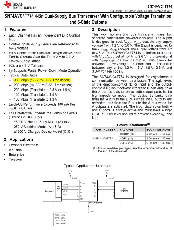

I would like to check if there are any data on the propogation delay on the DIR pin before we can change the direction of the A and B port?

Hello Ivan,
So sorry for the delay. After reveiwing the characterization data, there is no data on the propagation delay from the DIR pin to the change in direction of the A and B port.

Hello Ivan,
We do not currently spec the delay for DIR pin but there is a rule of thumb that the minimum time needed is the minimum pulse width that is derived from the data rate. Per the datasheet we see that for VCCA=1.8V and VCCB=3.3V we have a typical data rate of 380 Mbps, thus we take the inverse to get the minimum pulse width which gives: ~2.63nS. Let me know if this is not clear or if you have any other questions.
